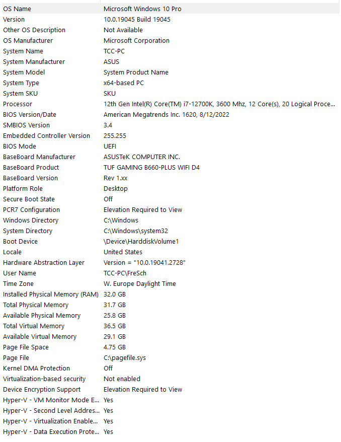

  4. franco d'esaro 25,181 Reputation points Volunteer Moderator
    2023-09-19T19:24:00+00:00
    Simply post a screenshot of the System Information page.
