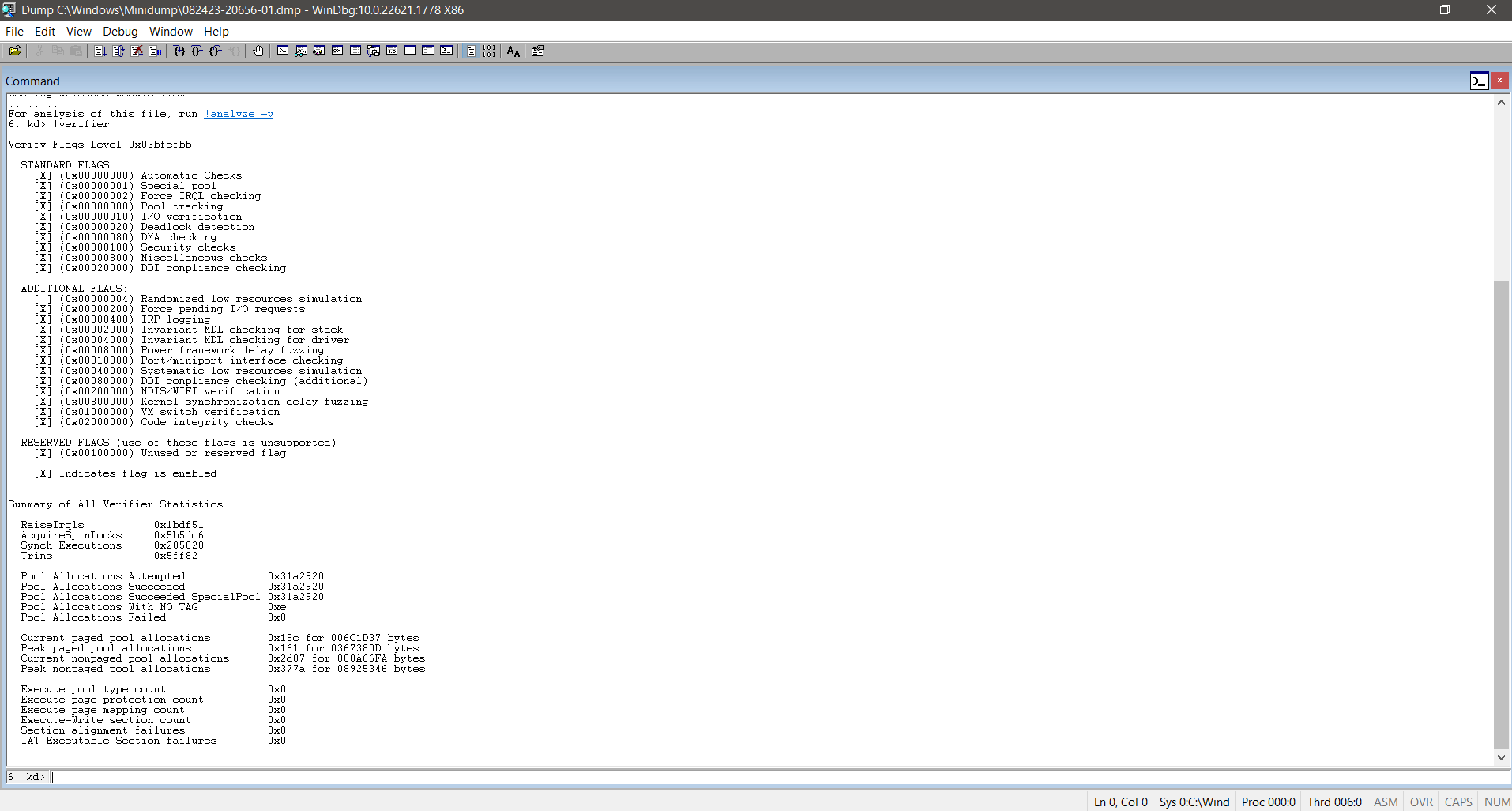

    2023-08-24T09:18:04+00:00
    This is what I see for device verifier being on for the dumpfiles. Only the newest 3 has driver verifier turned on. The first two does not
