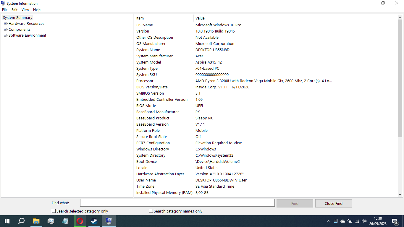

So I tried turning off ULPS from AMD, then after I turned it off I immediately restarted the laptop, and since then Windows stuck happened, every time I restarted it would definitely get stuck when loading, but when I opened BIOS F2 then returned to Windows, it didn't cause a stuck and I was still able to open windows as usual, then I immediately turned ULPS back on, and I tried restarting again to see if it was still stuck, and the answer was yes, even though I had turned on ULPS the stuck still happened and I didn't know what to do, I've searched tutorials on YouTube but none of them are the same as mine, so now I have to type F2 quickly every time I want to use my laptop so it doesn't get stuck at the Windows logo, is there a solution? and I've reset Windows, and I reset my entire hard disk too, and it still happens.

    1. I've enabled ULPS via Registry editor, and the problem still occurs. and I've tried turning on ULPS via BIOS but the menu for turning on ULPS is not in the BIOS, it can only be turned on via redegit, or I have to activate something for the ULPS menu to appear, I don't know.
    2. The problem doesn't seem to be the BIOS, I've updated the BIOS via Windows update, when I reset Windows, I immediately opened Windows Update to look for the latest update because I was also thinking the same thing, then the BIOS update appeared, I installed it and it's still the same .

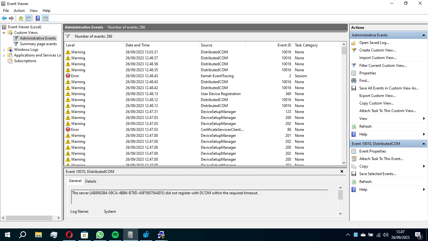

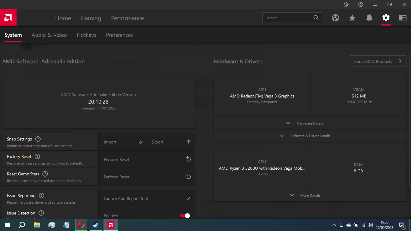

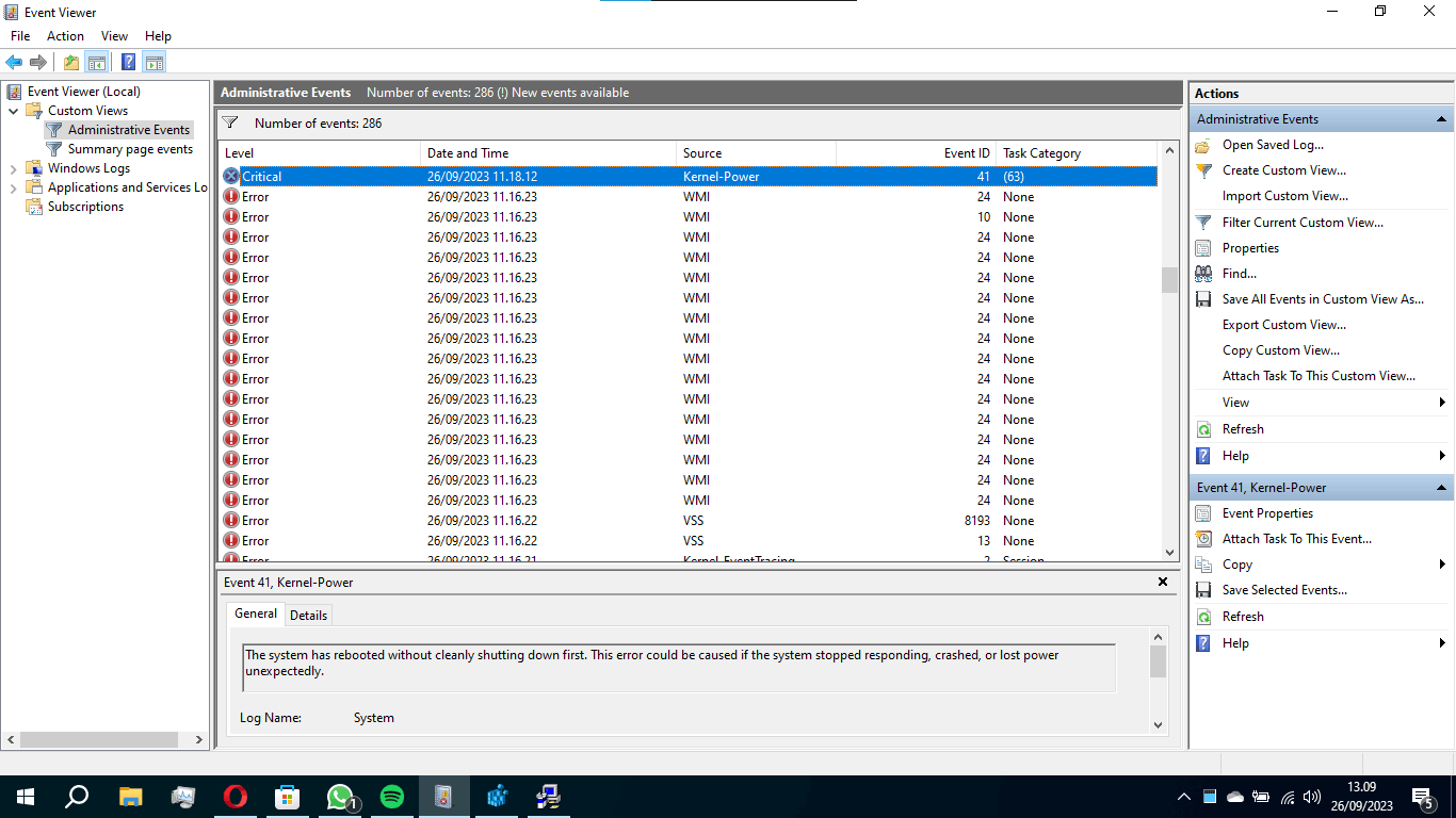

    Note : AMD often crashes, if I open driver settings via AMD it will force close, I've updated via the official website and the results are still the same, and I've searched AMD forums, they mostly send the same task viewer images as I sent before, there are 289 reports from warning to critical, and I don't know what that means at all, do you need the report or is there something you want to need? because I'm confused, and why does turning off ULPS cause it to get stuck loading Windows and when I turn it on again the problem is still there?
