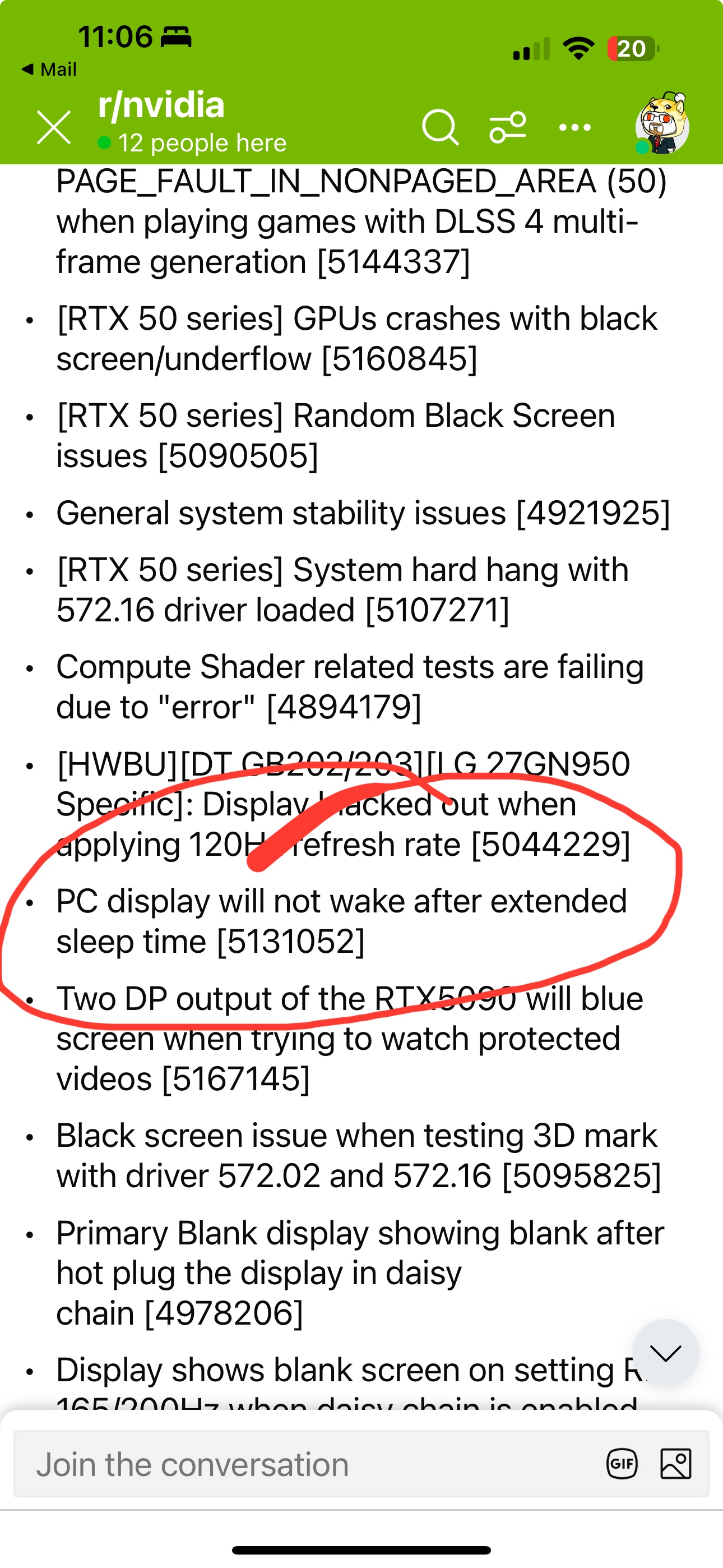

    Finally!
    After a year of searching for solutions this seems to have finally fixed it ๐ŸŽ‰๐ŸŽ‰๐ŸŽ‰
    Thanks so much for the Nvidia driver hint!
    I have tested it for a bit after updating the driver and it really seems to have fixed the stalled wake after sleep behaviour.
    2025-04-17T03:12:03+00:00
    Ah ha! It seems itโ€™s an Nvidia driver issue and they say itโ€™s been corrected in the latest driver 576.02
