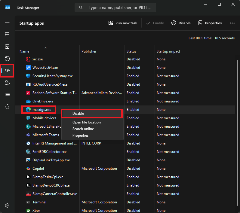

Step 3: Peform the clean boot option: https://support.microsoft.com/en-us/topic/how-t...
I hope this will help you to sort out the issue. Please let me know if you need further assistance. Thank you!
