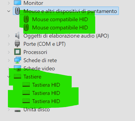

    I also have the same problem with random connection and disconnection of USB peripherals with Windows 11. Sometimes they reconnect, other times I have to restart the PC because even the keyboard and mouse stop working.
    I have tried different mice and keyboards, but the problem persists. Sometimes everything works perfectly for days, then it happens frequently, and then everything is fine again.
    It is very frustrating, especially while working, as there is a risk of losing all the work done. I have always been a Windows user, but this is making me want to stop using Win11, revert to Win10, and disable all updates to avoid it updating to 11 again even if I don't want it (as has already happened to me).
    Here is something that might help identify the problem.
    In trying to find a solution by doing a clean installation of Windows 11, I formatted and reinstalled, but the problem reappeared. This issue with the mouse stopping working happened to me during the installation of Windows 11. It completely froze on the first screen AFTER the operating system was installed.
    Here is my PC configuration (purchased in April 2023):
    CPU: Intel Core i9 13900KF
    Motherboard: AsusTek Prime Z790-P
    BIOS version 0809 01/06/2023
    RAM: 128GB DDR5
    Graphic Card: Nvidia GeForce RTX 4070 Ti
    Currently, to isolate the problem and ensure it is a USB issue, I am using the mouse and keyboard connected to a Type-C Hub.
    Thinking about it, on Windows 10 with different hardware (from 2011), I did experience storage peripherals disconnecting and reconnecting. However, it happened very rarely, and it never occurred with the mouse and keyboard as frequently as it does on Windows 11.
    In Device Manager I see 2 devices for mouse and 3 for keyboard. Coould this be the cause?
    I look forward to any updates!
