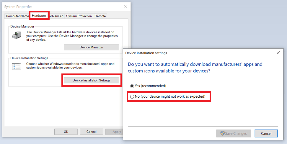

I should add going to control Panel, search for Device Installation, select change device installation setting to NO- does fix the error.  Tested, reboot or adding external drive no longer gets the 131 error.  Now is this a good idea, I don't know, I am not that up on computers anymore.  I retired in 2003 after 38 years as system software tech on mainframes.  Was certified also for Microsoft, but a lot changed since then and I really don't attempt to keep up.

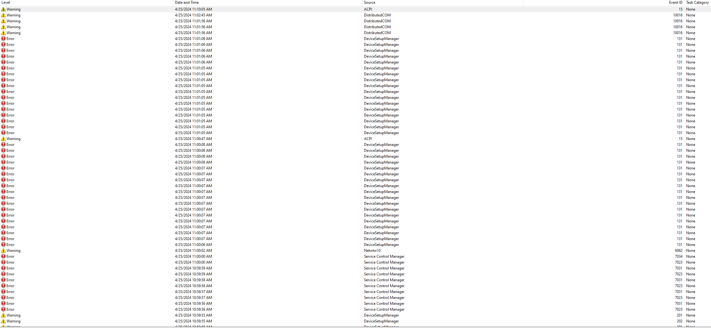

    This issue has been reoccurring on my 3k gaming pc i built. I thought windows 11 was a step forward but i was wrong.
    At least some cuck independent advisor hasn't come in here and closed/Resolved the topic with generic misleading response XD.

    The DeviceSetupManager Event ID 131 errors being discussed in this thread do not cause any noticeable problems on my Dell Inspiron 5584 laptop (e.g., like high CPU activity) so I'm just ignoring them for now and will wait to see if Microsoft releases a bug fix. If you think these errors are causing an issue on your own computer then use the workaround posted <here> on 23-Dec-2023 on page 1 of this thread (i.e., change the Device Installation Settings to "No" in your Advanced System Settings) to see if this stops your DeviceSetupManager Event ID 131 errors.

    Try adding a printer and see how long it takes for it to be moved from the "Unspecified" device group to the "Printers" device group. Choose ADVANCED SYSTEM SETTINGS in the right-panel of the ABOUT screen (accessible from the SYSTEM Settings screen) and Hardware tab --> Device Installation Settings --> Answer this question: DO YOU WANT TO AUTOMATICALLY DOWNLOAD MANUFACTURES' APPS AND CUSTOM ICONS AVAILABLE FOR YOUR DEVICES? *YES (RECOMMENDED) OR *NO (YOUR DEVICE MIGHT NOT WORK AS EXPECTED).
    On any of my thousands and thousands of systems, when YES (default) is the selected option, it takes several minutes and, when NO is selected, it is instantaneous.
    I demonstrated it for a crowd of Microsoft Support engineers. They quickly got the point and sent this case to the group responsible for the Metadata Staging servers.
