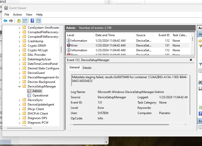

    Hi thank you for this info. Looks like 131 error stopped after I did the work around you suggested but there are still other errors (202, 200, 112, 201)

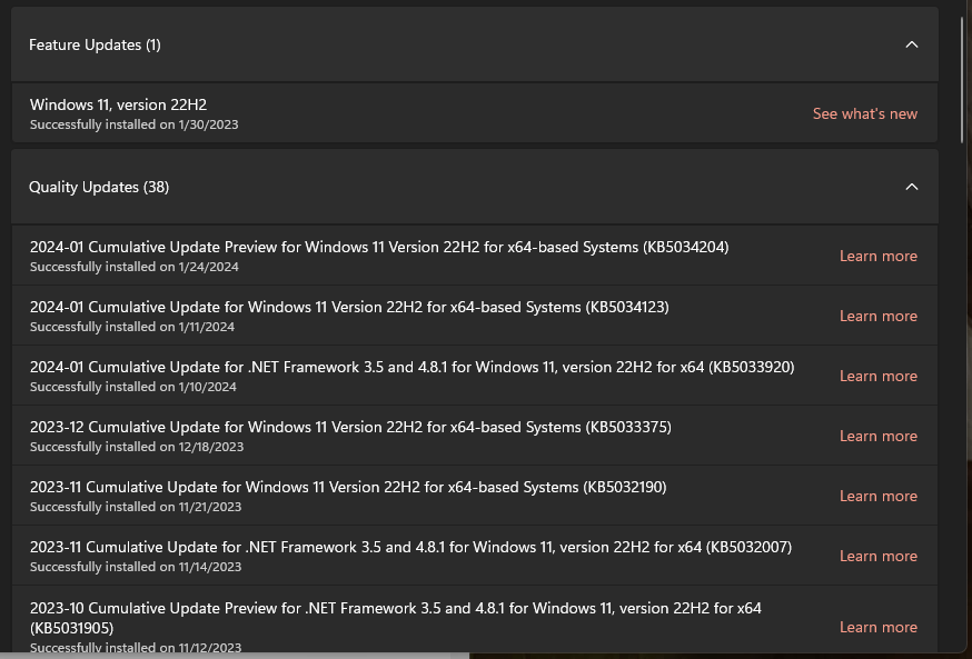

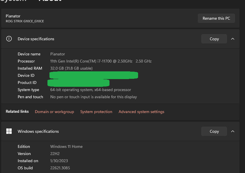

    So install windows 10 and then update to windows 11 again? I just want to make sure I am doing the right thing :) I also installed the windows update they pushed out this morning and it seems to be working slightly better but still got the BSOD again a little earlier after trying to open youtube.
