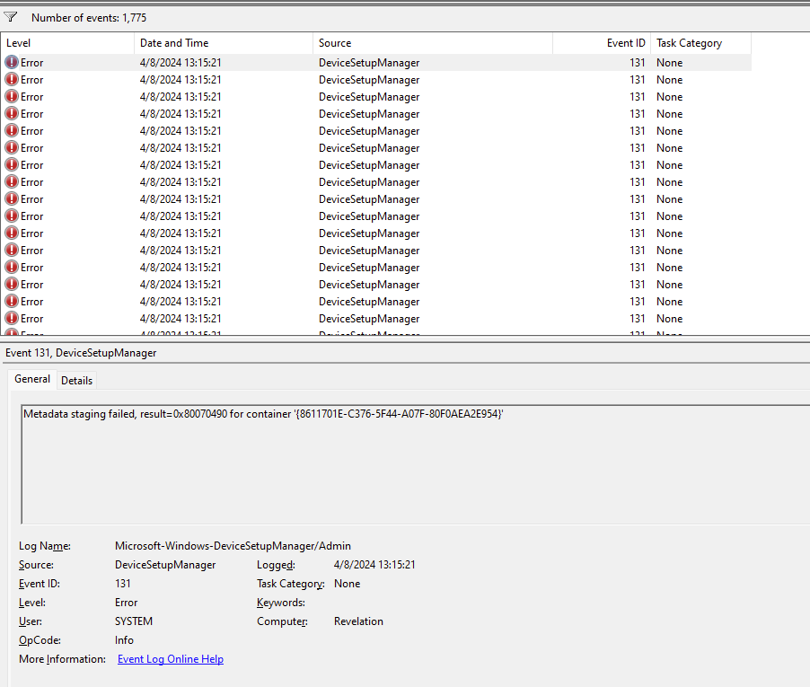

Device Setup Manager Metadata staging failed Event ID 131
2023-12-08T03:12:46+00:00
I did KB 890830, KB5032339, KB5032189 and KB4023057 today and on reboot after updating I started getting many of the event id 131 Device Setup Manager Metadata staging failed.  I would get the code 131 when plugging in my backup USB external.  Even when using USB thumb drive- this never happen prior to today's update.  Also, lots of the Event ID on boot. Never had these prior to the update. I am on WIndows 10 PRo, 22H2, OS Build 19045.3693, Dell OPtiplex 64 bit, 12GB memory and 500GB disk.
I got to looking at the registry for devicemedadataserviceURL.  I went to that URL (go.microsoft.com/fwlink/?linkid=252669&clcid=0x409) and got redirected  as site not available to  dmd.metaservices.microsoft.com where I pressed continue and got a 505 Bad Gateway error.
And then just for the heck of it I did a DISM with /checkhealth and all was good, did DISM with /scanhealth and it said all was fine.  Even did sfc /scannow and chkdsk, all was well. NO system files missing or disk problems.
Then I did some thinking (which can be dangerous)  Booting or adding external drives got many of the 131 errors.  However when I disconnect from the internet and boot system or add external drives-  I GOT NO ERRORS Event code131.
Between all this, I believe our friends at Microsoft have a bad pointer. in the registry entry devicemedadataserviceURL.
I did an image of system prior to updating, thought about restore and still considering.  All is working fine, I tried all devices and all are working.  I shouldn't look at that event log!  I just today after the mentioned above updates started getting these errors.
I should add going to control Panel, search for Device Installation, select change device installation setting to NO- does fix the error.  Tested, reboot or adding external drive no longer gets the 131 error.  Now is this a good idea, I don't know, I am not that up on computers anymore.  I retired in 2003 after 38 years as system software tech on mainframes.  Was certified also for Microsoft, but a lot changed since then and I really don't attempt to keep up.

    I still have this issue... My computer hangs and I have to manually press the reset button.
