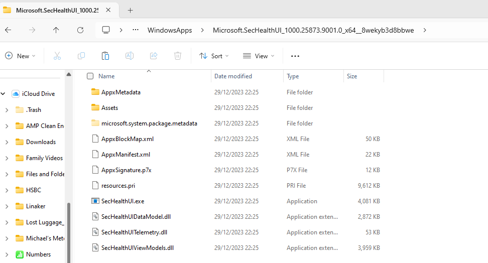

    The same model Vaio (my Daughters) that runs Security ok is operating the GUI (SecHealthUI.exe) from this loaction
    C:\Program Files\WindowsApps\Microsoft.SecHealthUI_1000.25873.9001.0_x64__8wekyb3d8bbwe.
    Whereas the laptop with issue seems to have the files here C:\Windows\System32\SecurityHealth. Any thoughts on whats going on here ? I was tying to replicate the set up when I came across this.
    Thank you
    Frank
