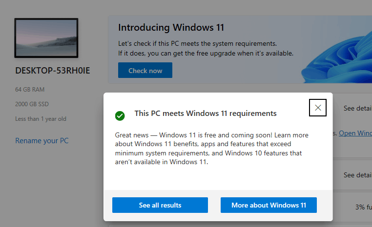

    2024-03-06T02:58:59+00:00
    I initially used Rufus to create a bootable media without having the checks enabled, but even with secure boot the installs were still similar
    so I ended up installing W10 as you suggested and ran the PC health check and it came back as expected
