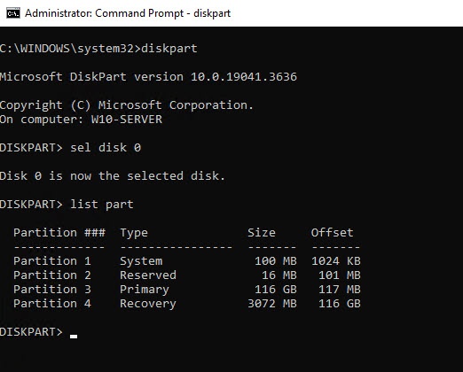

    Also, disk clean up (cleaned up everything, including runiing the system clean up) did not help.
    I am using W10 Pro, and to recap ...
    I don't have bitlocker turned on, and recovery disk is at 3GB
    still not working

    I have tried to enable WinRE, but I get an error stating that it can’t be enabled on a bitlocked drive.
    In an attempt to resolve the update issue, I deleted the old WinRE partition, created a new partition, then using Powershell attempted to enable WinRE via the Powershell command line.

    I am having this same problem. No problems resizing my recovery partition, in fact its now up to 1.95GB - but the problem with the Windows updates failing still exists for me. Have spent hours on this. Is there a fix coming?
