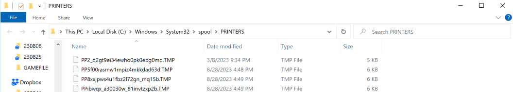

    I scoured different advice on the internet and found a solution. I stopped the print spooler and then issued the following from the Run command: C:\Windows\System32\spool\printers. It displayed 4 temporary files, which I deleted (CTRL A +Del). I restarted the spooler and tested the Scanner error problem both with the screen saver and turning off my pcs (both of them) and printing. NO ERRORS!
    Microsoft is putting unseen temporary files in the print queue with Windows 11. This happens even with a clean install of the O/S. Here are the files:

    UPDATE!!!
    Microsoft still leaving files behind causing the printer to send the scanner error.
    I thought the fix I applied worked but I apparently missed something.
    My screen saver kicked in and when I got back to my pc, it started the grunting noises and spewed out the scanner errot msg.
    I stopped the spooler and found some files there using that command. Deleted them and started the spooler again.
    Five months Microsoft. Please fix this,
    Here are the latest leftover files:
