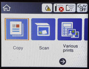

    From my perspective, the operating system is not releasing the printer properly after a job is printed. There has been some improvement but it is transitory. When I print something, it seems to me that the printer is waiting for another job. The display on the panel is this:
    It does not revert to the "idle" display:
    If I print something and manually close the "Printing Complete", it now takes over an hour to generate the error message. In the past, the error would happen within 10 or 15 minutes. The only way to prevent that is to power down the printer and restart it. The printer is clearly waiting for release from the operating system.
    If the printer's screen saver is activated, the time for the error message to appear is shorter. However, if I turn my pc off completely, no error message is generated.
    My question to Microsoft is why doesn't the operating system release the printer? I can work around this bug by turning off the printer every time I know there will be some lapse between print jobs but I forget to do that sometimes. The amount of wasted paper in over 6 months of this remaining a bug is truly aggravating.
