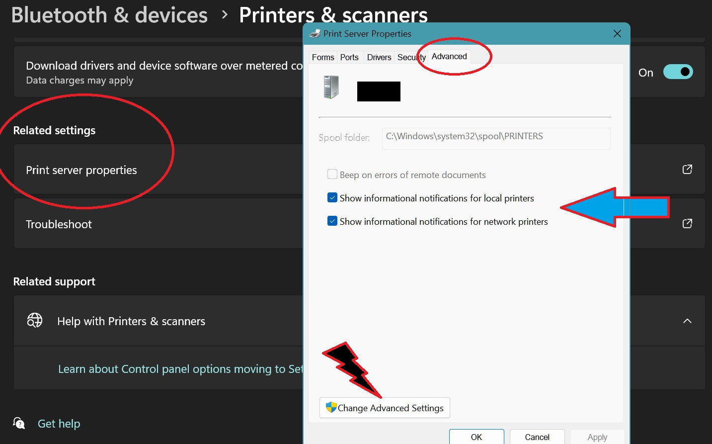

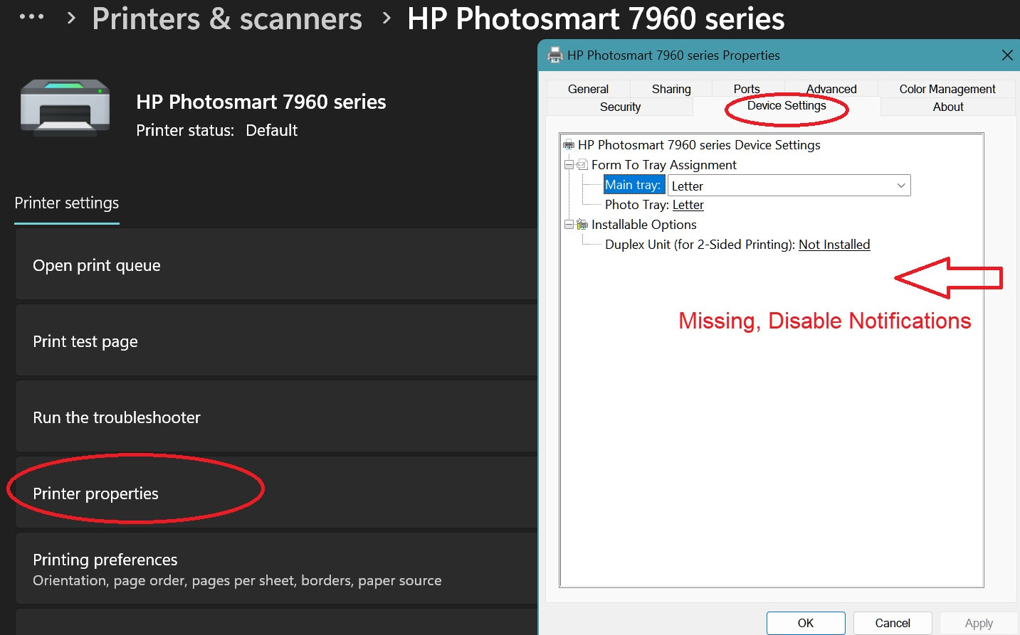

    I think I finally figured it out for me. Maybe it will help others too. Most advice tells you to find the Installed features or Installable options, but this is wrong.
    Instead you need to scroll down to related settings and Print Server Properties:
    Then the Advanced Tab, then click Change Advanced Settings, then uncheck Show... for both of those.
    I wasted so much photo paper before I figured this out!! So whoever said this is a Windows problem not a printer problem, you're right, Windows hasn't updated any documentation of this feature yet.
