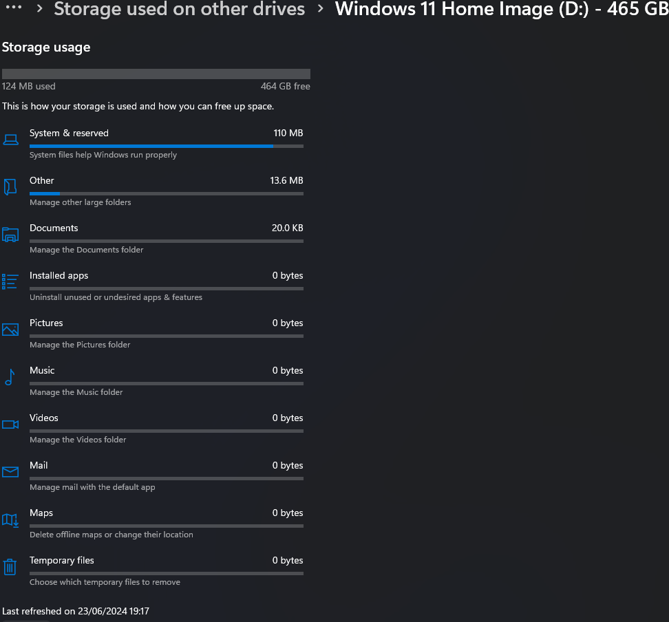

    2024-06-23T18:33:18+00:00
    Viewed Boot Manager:-
    1. BIOS mode is UEFI
    2. Boot Option #1 is MSI M390 500GB. This is Disc 1's EFI
    The following is properties of D:\ drive (Disc 1)
    It was a clone of C: but now contains nothing.
    So booting from D;\ EFI partition but using C:\ data partition. D:\ is the onboard MSI M390 which is what I want to boot from but need C:\ data partition copied to D:. If this successful can remove disk 0 (C:) which is Samsung EVO
  3. Ramesh Srinivasan 87,435 Reputation points Independent Advisor
    2024-06-24T02:49:42+00:00
    //So booting from D;\ EFI partition but using C:\ data partition. D:\ is the onboard MSI M390 which is what I want to boot from but need C:\ data partition copied to D:. If this successful can remove disk 0 (C:) which is Samsung EVO//
    That's correct. However, change the boot order to Disk 0 to verify if it boots correctly.
    If it does, clone Disk 0 to Disk 1 and then detach Disk 0.

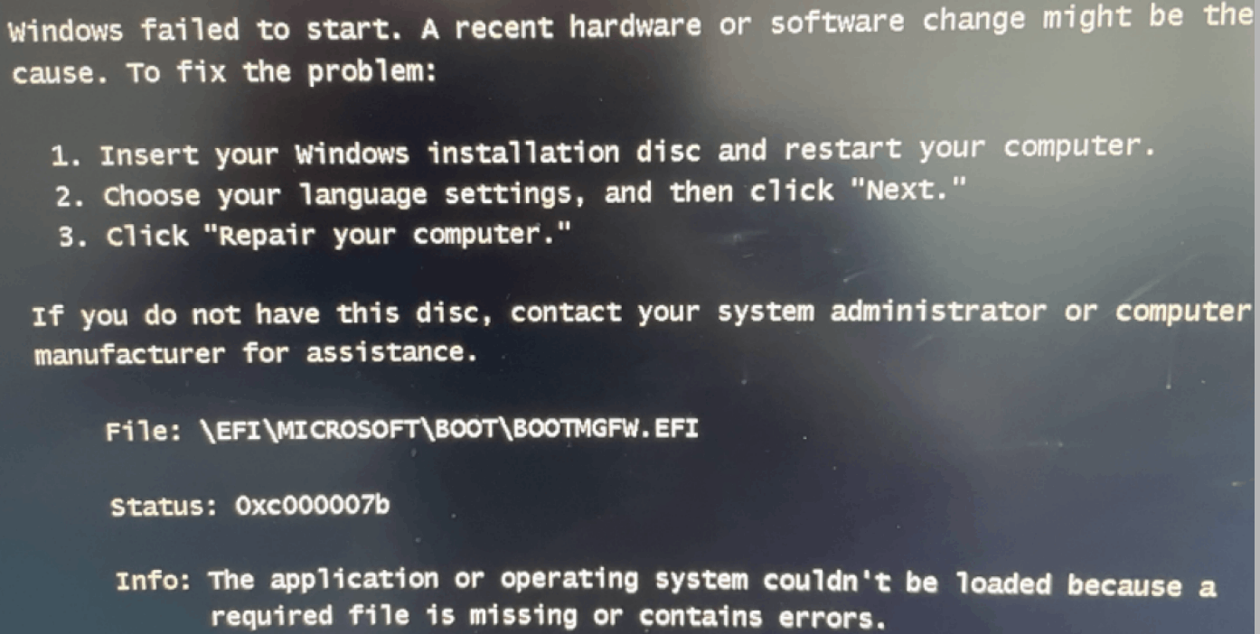

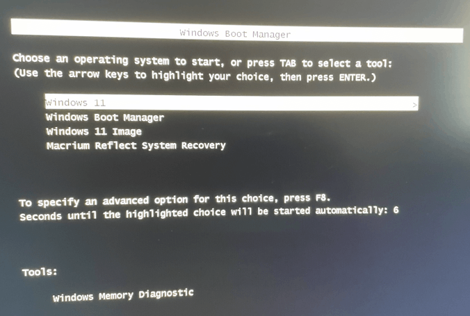

    PC Start-u screen options:-
    With windows 11 selected (by default) system boots no problem. Under our understanding from previous posts this option is using disc 1 (MSI D:) EFI partition and disc 0 (Samsung C:) data partition
    If I select "Windows 11 Image" then I get:-
    Here I'm assuming it's using Disc 1 EFI to boot and wanting to use disk 1 data partition. This used to be a clone partition - a Windows 11 Image - but has since been deleted/formatted, so no Windows data to start up. Let me know it assumption is incorrect.
    So disk 1 not booting correctly but then neither is disc 0 since its using EFI from disk 1 and data partition from disc 0. (what went wrong for this to happen a mystery)
    My expectation is 1) Windows 11, disc 0 (Samsung EVO) EFI and disc 0 data (would be if only one disk)
                              2) Windows 11 Image disk 1 (MI M390) EFI and disk 1 data
    My view is we need to copy data partition of disc 0 to data partition of disk 1, thus allowing disc 0, the Samsung EVO, to be removed. Agree ??
    Hopefully I haven't made mistakes in understanding (or typing)
  5. Ramesh Srinivasan 87,435 Reputation points Independent Advisor
    2024-06-24T15:16:23+00:00
    //So disk 1 not booting correctly but then neither is disc 0 since its using EFI from disk 1 and data partition from disc 0. (what went wrong for this to happen a mystery)/
    Still we don't know which disk you're booting from. Check your UEFI settings. Or disconnect disk 1 and boot from disk 0.
    If disk 0 boots fine, clone disk 0 to disk 1 and detach disk 0.
    //My view is we need to copy data partition of disc 0 to data partition of disk 1, thus allowing disc 0, the Samsung EVO, to be removed. Agree ??//
    Yes. But, as I said we need to determine if disk 0 can boot correctly without the presence of disk 1.
