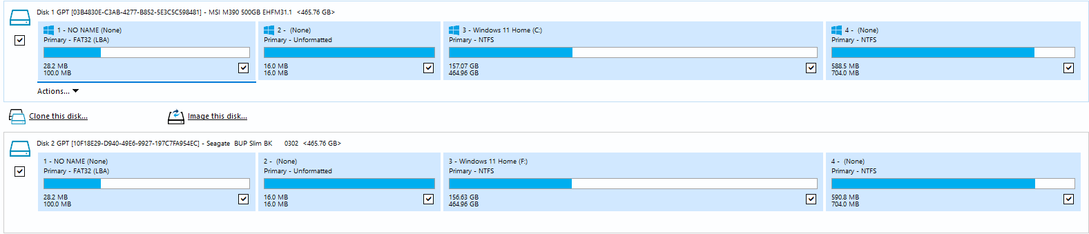

I've been having problems regarding SSD cloning. Macrium have been very helpful. It appears that I'm booting from the 2 installed internal hard drives (!?!).
It was working OK for ages but obviously something subsequently has happened.
It was recommended I clone to an external drive.
Fortunately I had a another SDD that I could use. I reformatted this and connected externally . Checked with file folder that it could be read and was empty. All good.
Used Macrium to clone but was concerned that if supposedly booting form 2 internal drives, what am I copying, and would it work?
It didn't!
Both drives had 3 partitions; An EFI System partition (100MB), Windows 11 Home partition (465 GB) and a Recovery Partition ((610MB)
To cut long story short, the external drive now consists of 2 partitions, The EFI partition and an unallocated partition.
The external SDD is no accessible !!. I get the message "You currently don't have permission to access this folder" and continuing, "You have been denied access to this folder" " to gain access to this folder you will have to use the security tab"

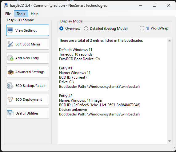

    Used an app called EasyBCD to add external clone to boot manager:-
    I've been using this since Windows 8/10 days and initially OK on windows 11. I now get this message:-
    However, having added external drive (F:) using EasyBCD, Boot Manger gave me option to boot from internal MSI and also external (USB connected) Samsung.
    On (first) boot, selecting external clone SSD (F:) got error code 0xc000000f with file \windows\system32\winload.efi. I believed this SSD was an earlier clone but.....
    Ran Macrium and cloned MSI to Samsung. Program stated that it completed and was 100% successful.
    On (second) boot, selecting external SSD, got error code 0xC00000225 again file \windows\system32\winload.efi
    So, not booting when trying to use boot device. Suspect EasyBCD has disabled some functions as stated by message. Not yet researched error codes. Any thoughts ???

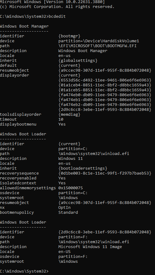

    H Remesh,
    I've run BCDEIT with External Samsung SSD connected:-
    What would I have to input to make Disc F: bootable ? This is the externally connected Samsung EVO. From previous post re error code (cxC00000225) infers BCD is either corrupted or missing.
  4. Ramesh 181.2K Reputation points Volunteer Moderator
    2024-07-15T15:08:20+00:00
    0xC0000225 is "The object was not found."
    Info: The boot selection failed because a required device is inaccessible.
    Renaming BCD and running "bootcfg /rebuild" is an option.
    If possible, please try this first:
    In the Boot order priorities setting in UEFI, take a photo of existing settings.
    Then. set "UEFI USB Hard drive" as the boot device.
    https://www.msi.com/support/technical_details/DT_Boot_Priority
