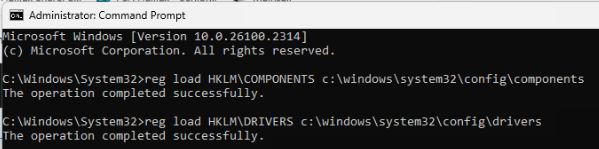

    I have the same issue with Windows Update.
    Can you help me fix it?
    Thanks in advance.
    Regards,
    Dima
    Hi Dima,
    From the admin Command Prompt, please run the following commands:
    reg load HKLM\COMPONENTS c:\windows\system32\config\components
    reg load HKLM\DRIVERS c:\windows\system32\config\drivers
    One of them might throw an error code. Post the screenshot here.
