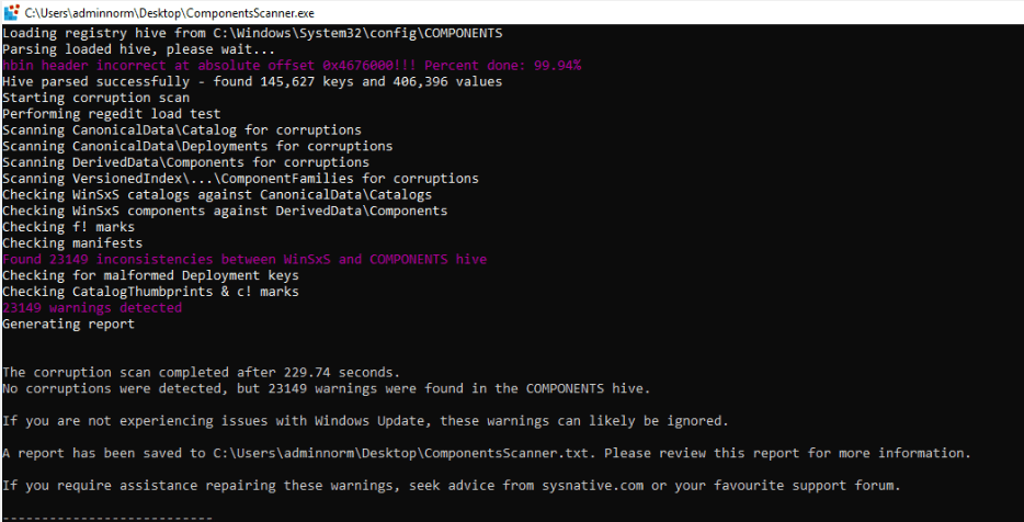

  3. Ramesh 181.2K Reputation points Volunteer Moderator
    2025-03-05T04:13:42+00:00
    @Joshua CWL
    Please find the corrected DRIVERS (Joshua CWL).zip
    For other users reading this thread:
    You can fix the COMPONENTS hive using this tool.
    https://www.sysnative.com/forums/threads/how-to-check-your-components-registry-hive-for-corruption.35379/
