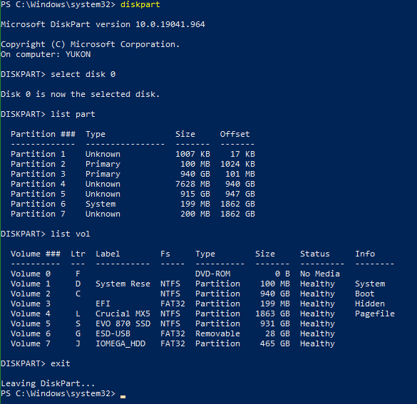

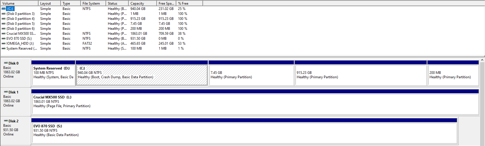

Ramesh 181.7K Reputation points Volunteer Moderator
2024-08-08T17:59:47+00:00
Hi Jean, Thanks.

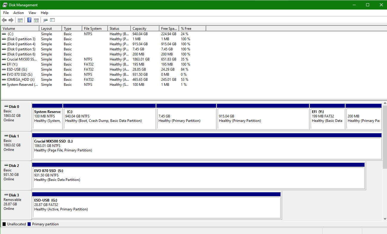

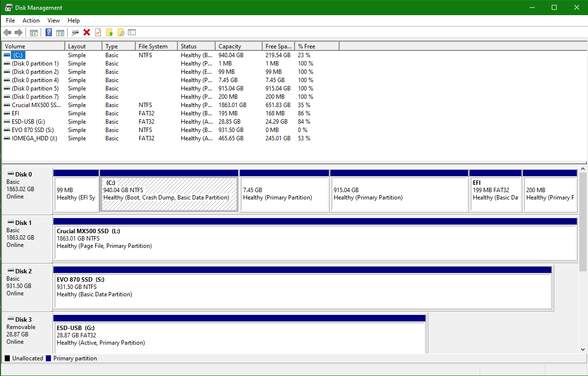

It looks like an issue with the EFI partition. Please open Disk Management and maximize it. Post a screenshot.
Open an admin Command Prompt and run:
bcdedit

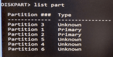

mountvol y: /s
diskpart
select disk 0
list part
list vol
exit
Post the output.

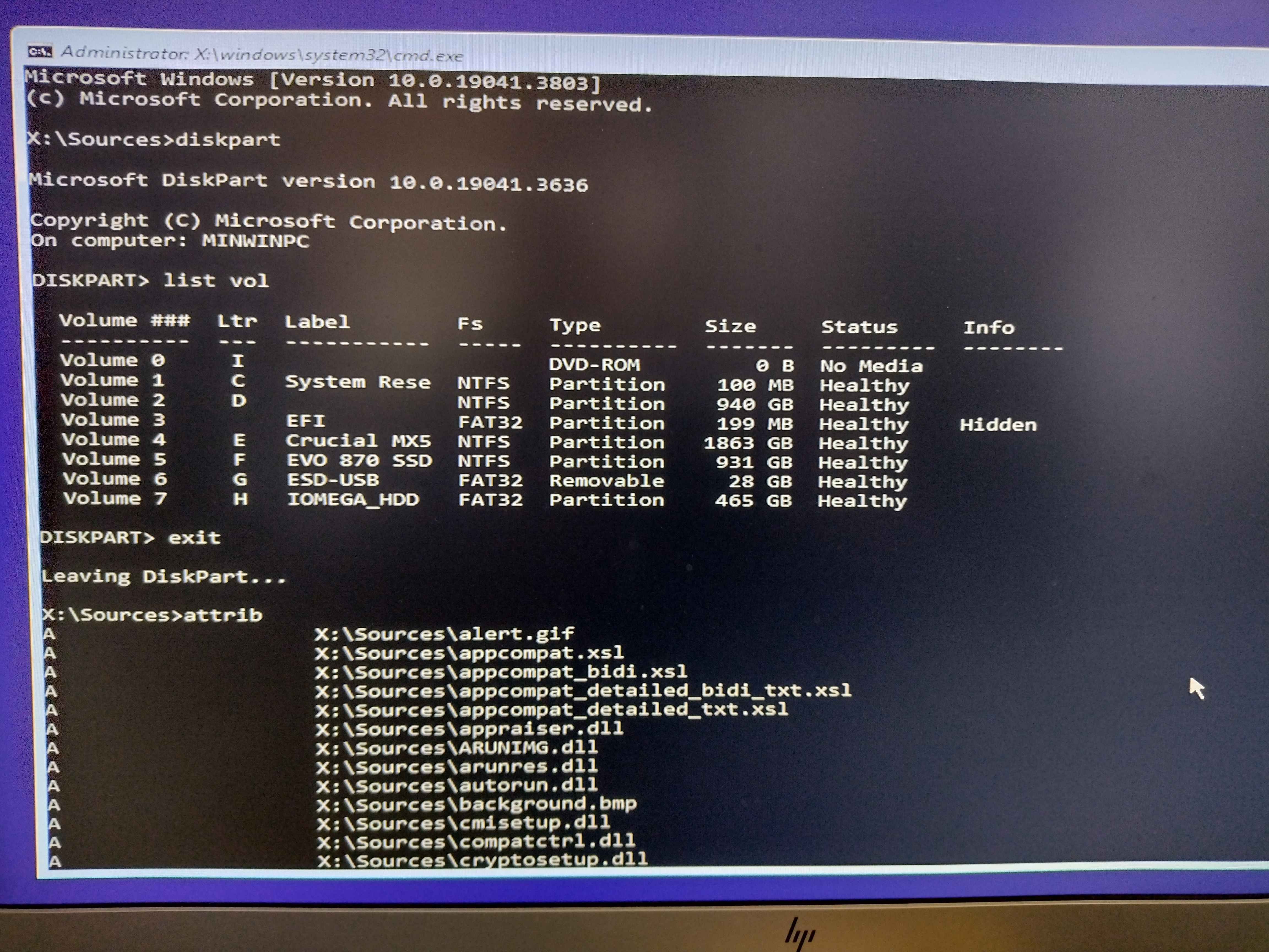

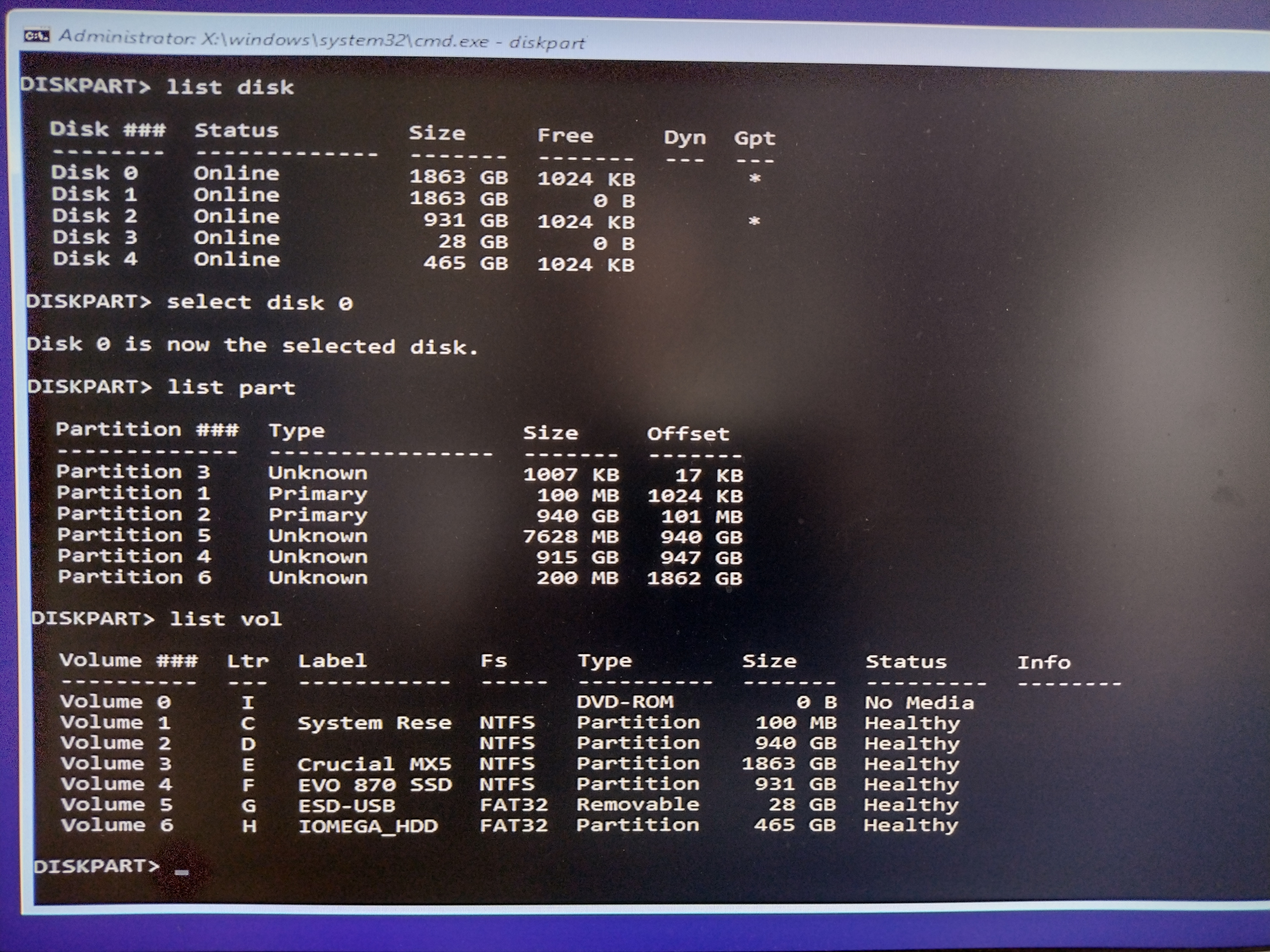

  1. Ramesh 181.7K Reputation points Volunteer Moderator
    2024-08-11T09:22:39+00:00
    Great. It looks fine now.
    Now, checking your Windows 11 setup log.
    2024-08-11T09:13:56+00:00

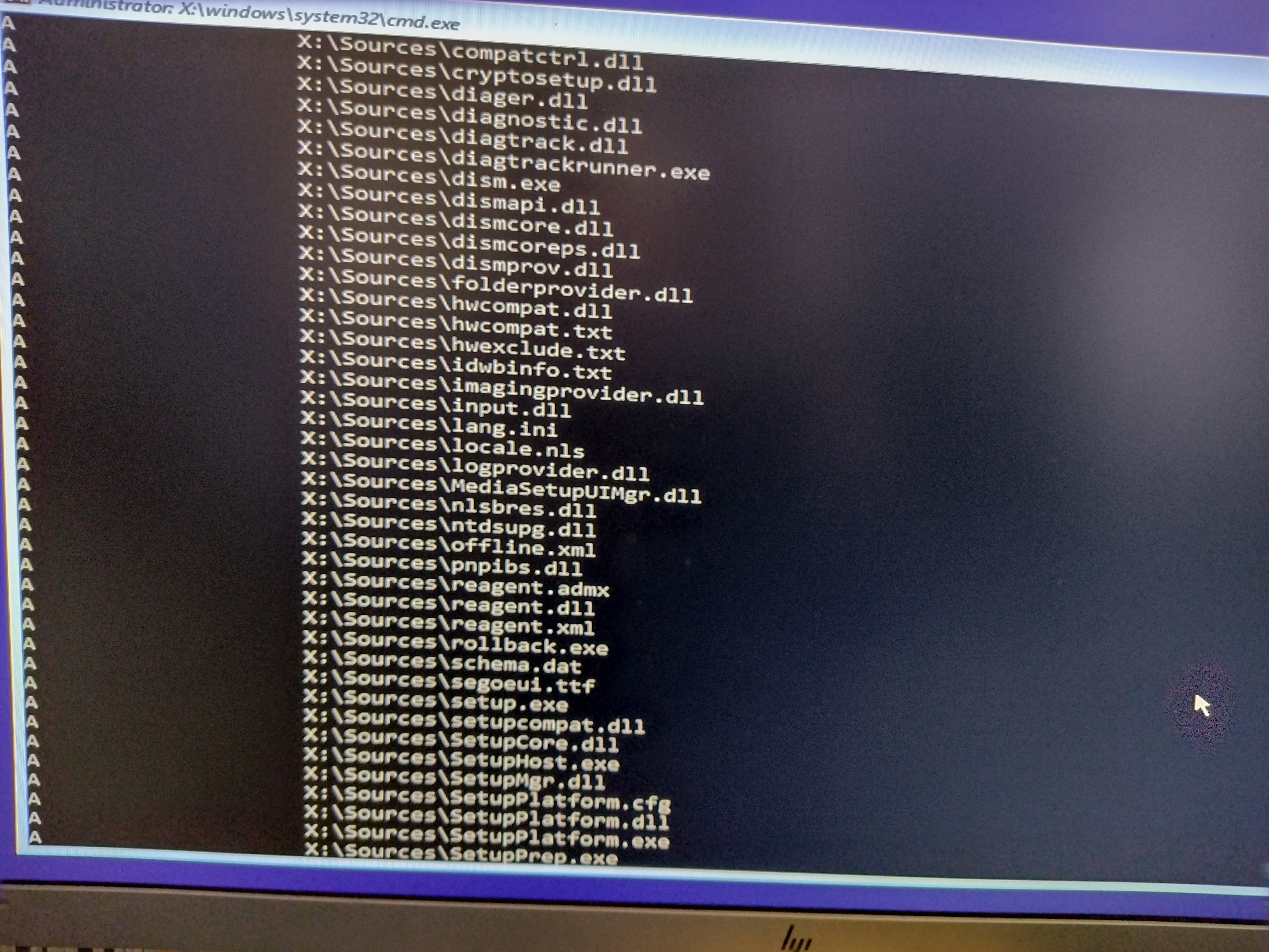

    ok so here are the screenshots from running WinRE:
    And here's the screenshot from the current state of my volumes:
    And finally the logfile you requested https://1drv.ms/u/s!AqQcGYDMvq8SiR3MhBjgVd-Xx85H?e=QPx95O

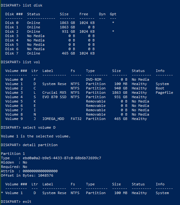

  3. Ramesh 181.7K Reputation points Volunteer Moderator
    2024-08-11T03:12:20+00:00
    Hi Jean-Loup,
    Glad the updates worked fine.

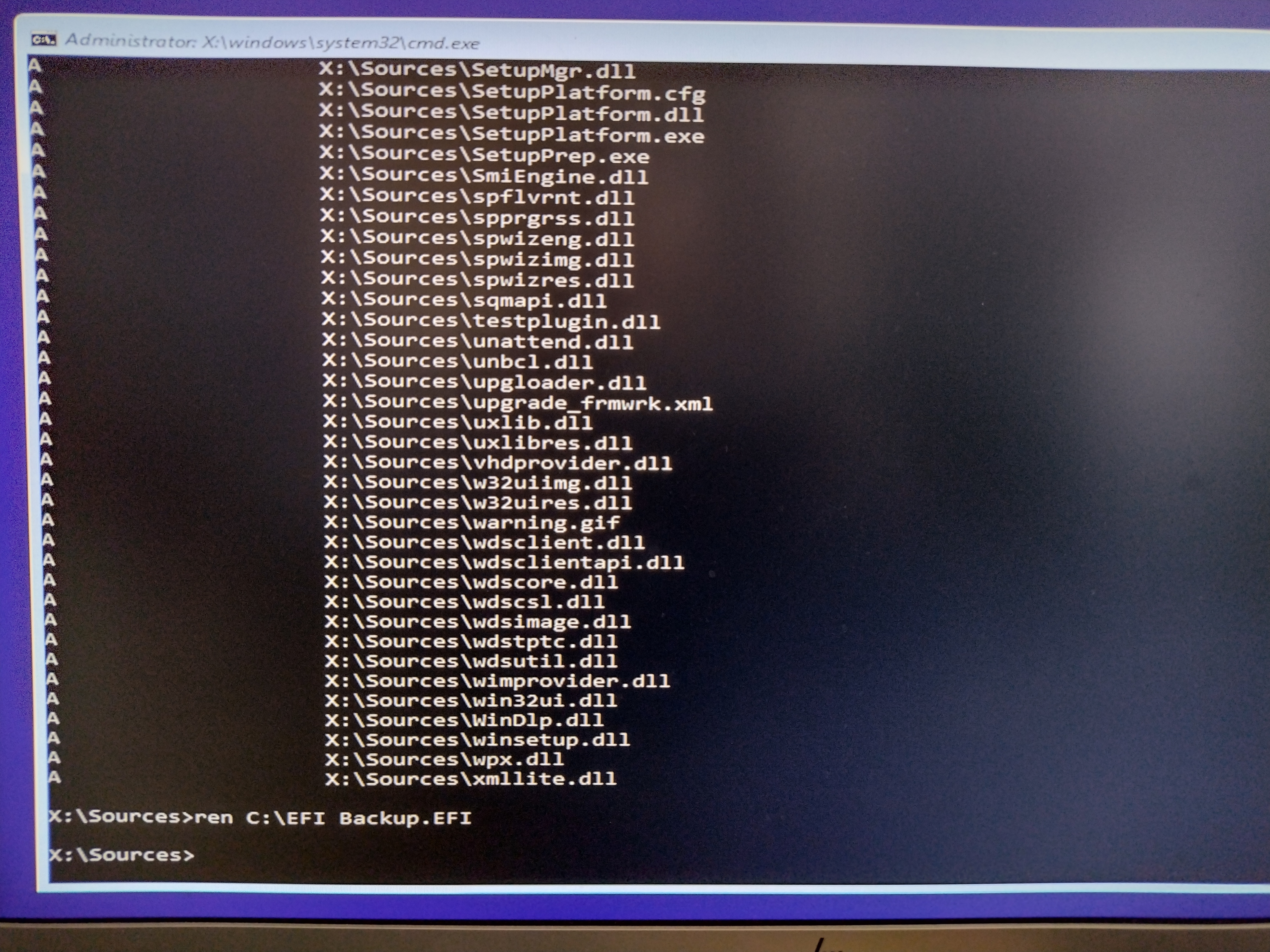

    1. Please boot into Windows RE and rename the "EFI" folder in the old system partition.
    From WinRE Command Prompt, run:
    diskpart
    list vol
    exit
    Note the drive letter of the 100 MB System partitions (which says "System Reserved"). Assuming it's C:\
    Then, run:
    attrib
    ren C:\EFI Backup.EFI
    Post screenshot.
    Start Windows and run:
    diskpart
    list vol
    exit
    Post output.
    1. The EFI partition is not assigned a drive letter. This is normal.

    2024-08-10T19:55:00+00:00
    Umm, odd, the new UEFI partition doesn't seem to have its assigned letter showing and I would have expected it to be volume 1 now?
    For the grub stuff, I took a backup of everything in the original UEFI partition on my One Drive so I'm hoping restoring it won't be too difficult

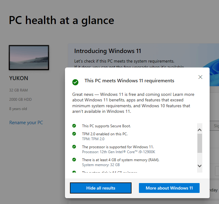

    For some strange reason I still have Windows Update tell me that my PC does not meet the minimum system requirements for the Windows 11 upgrade even though PC Health Check says otherwise but I'm hoping this will sort itself out.
