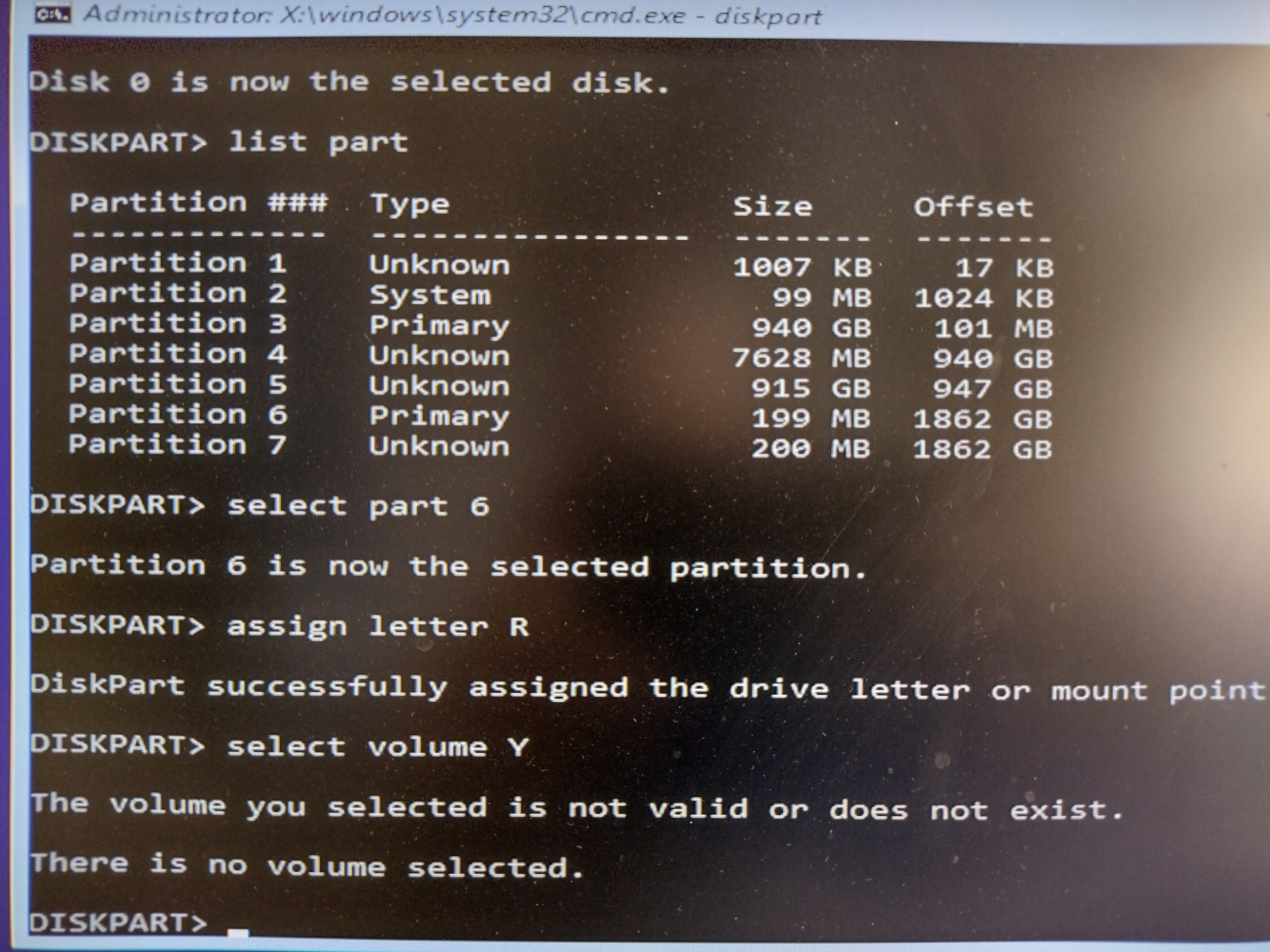

    2024-08-10T18:44:57+00:00
    My system doesn't seem to like anything that involves BCD, it fails at the bcdboot command, no matter how I format the drive letters:
    I have a feeling I did all of this from the Recovery USB drive last time, I don't recall whether it involved using BCD but I'm pretty sure the UEFI partition was setup from there

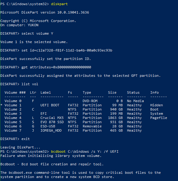

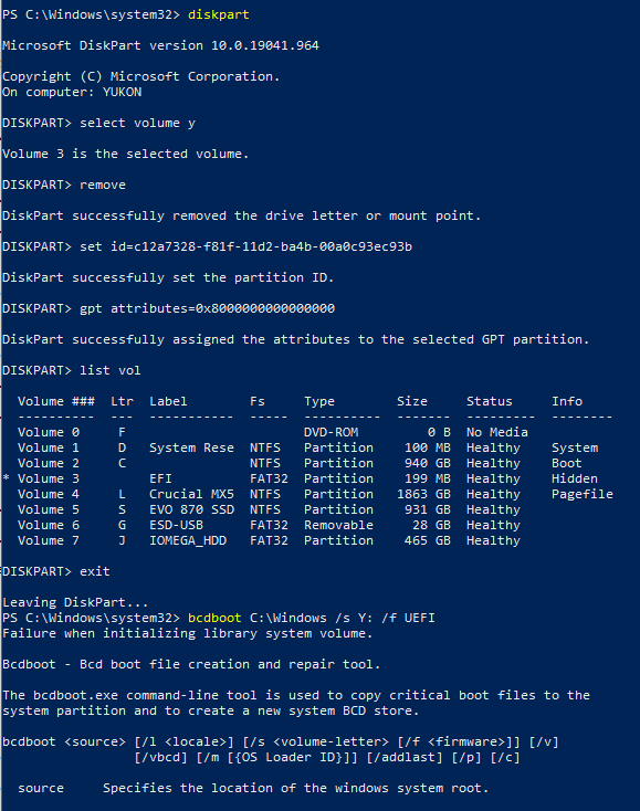

  2. Ramesh 181.7K Reputation points Volunteer Moderator
    2024-08-10T18:02:04+00:00
    Please run:
    diskpart
    select volume Y
    remove
    set id=c12a7328-f81f-11d2-ba4b-00a0c93ec93b
    gpt attributes=0x8000000000000000
    list vol
    exit
    bcdboot C:\Windows /s Y: /f UEFI
    Restart the system.
    Run
    BCDEDIT
    Post the output.
    See if you can install Windows updates.
    (If everything goes fine, to tidy up the disk layout, we may delete the 100 MB partition and create the EFI partition in that space. Once done, discard the 200 MB EFI partition.)
