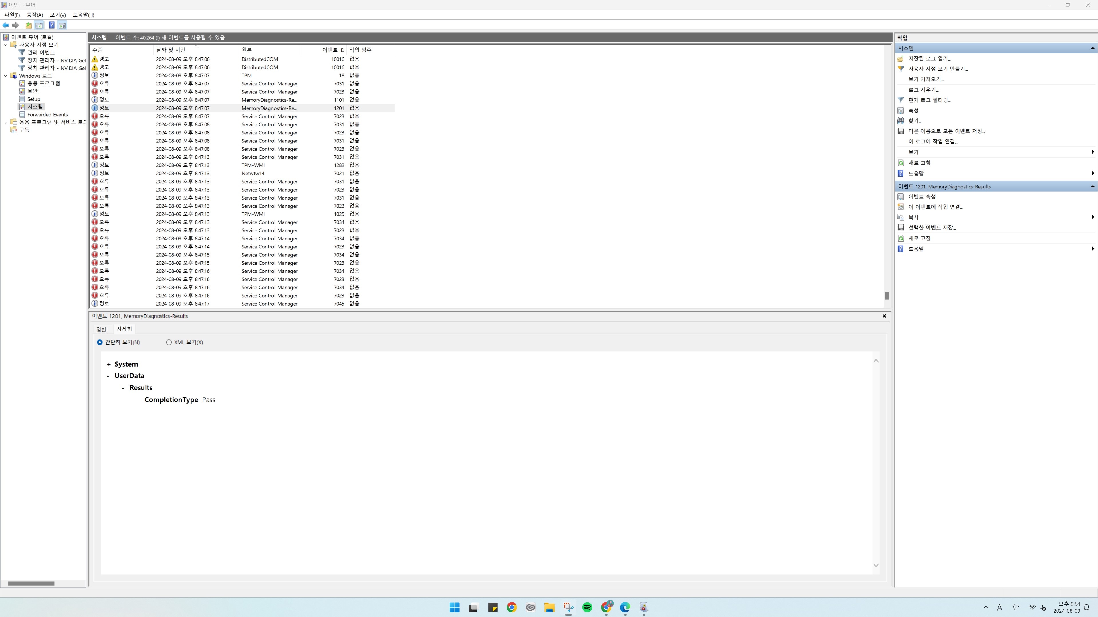

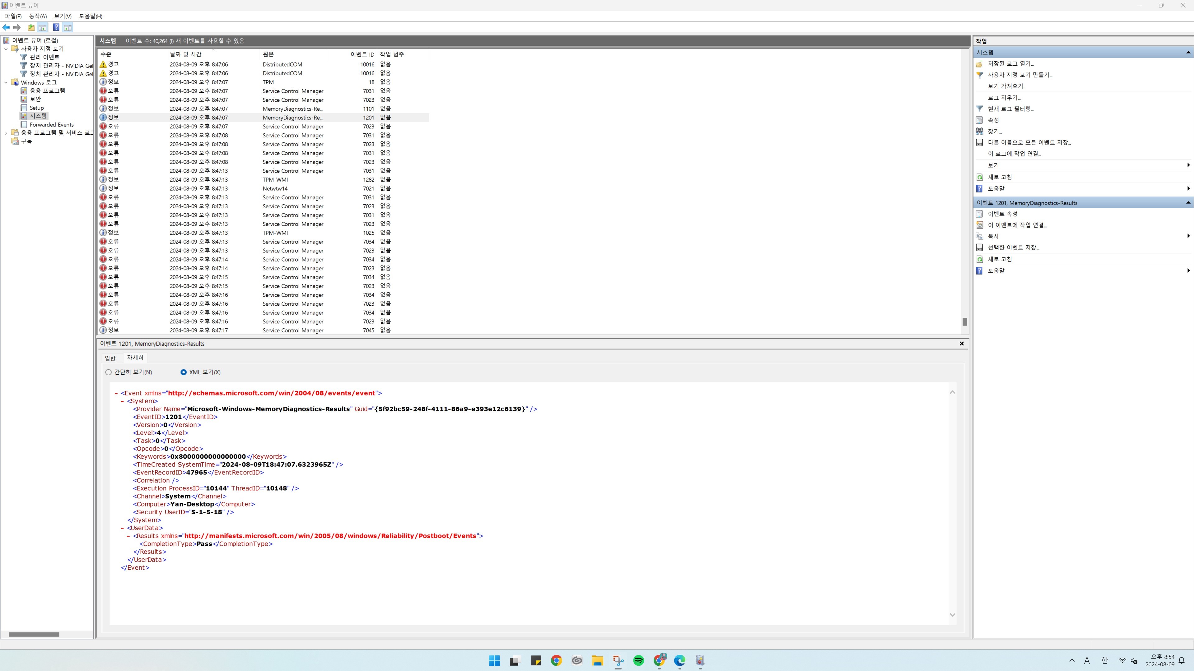

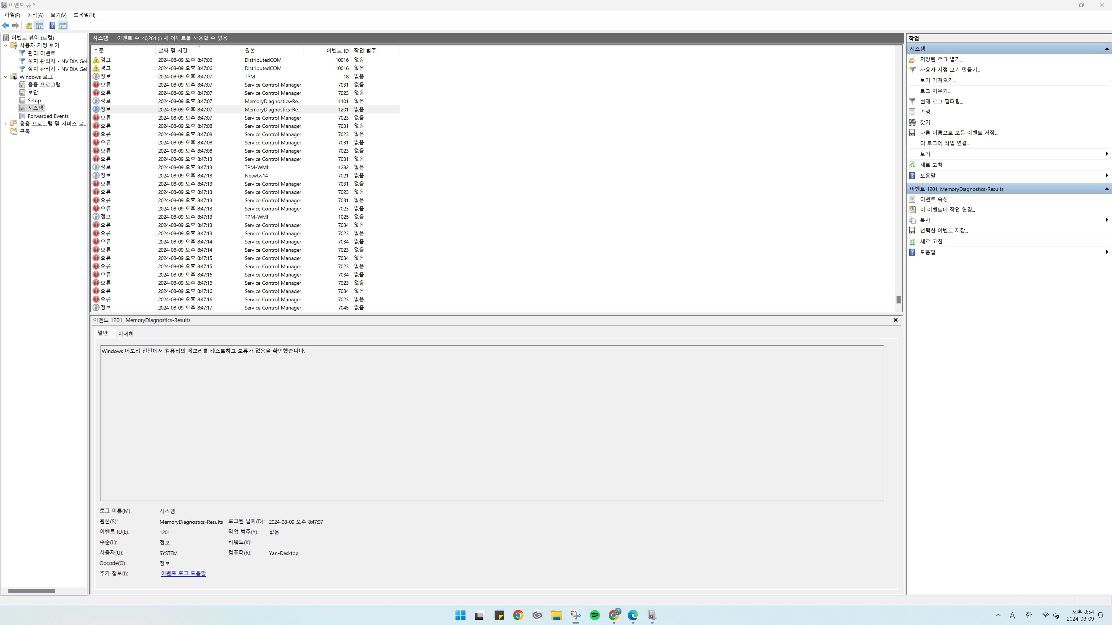

    2024-08-09T18:57:32+00:00
    Hello! The diagnosis is finally complete. It says that no issues were found. However, the Windows Update error and the missing icons issue still persist.
