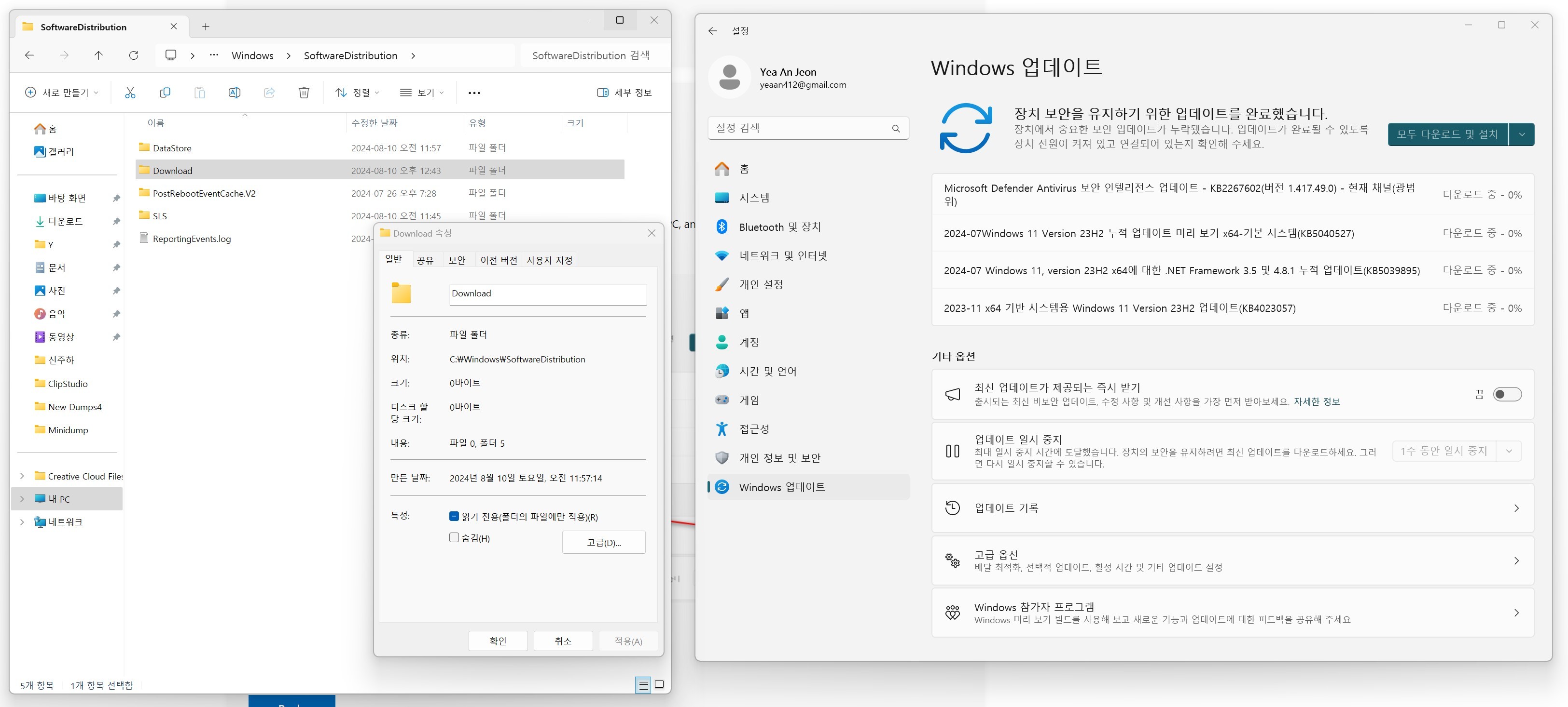

    I deleted the files and restarted the computer for the second time, but there was no change. The update window still looks the same as in the image below, and I can’t click the update button again.

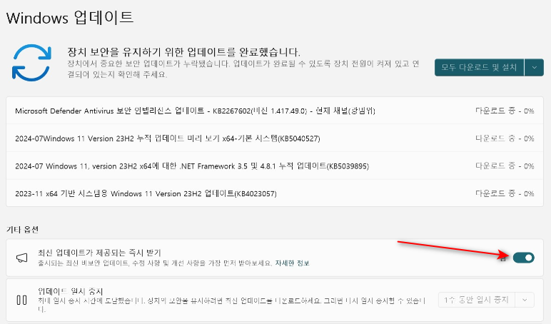

    2024-08-10T10:36:43+00:00
    Turn off the button shown below to stop optional preview updates.
    Open File Explorer, then navigate to C:\Windows\SoftwareDistribution\Download
    Delete the contents of that folder, not the folder itself and restart (not shut down) your PC, and try starting those updates again to see if the updates then start to install..
