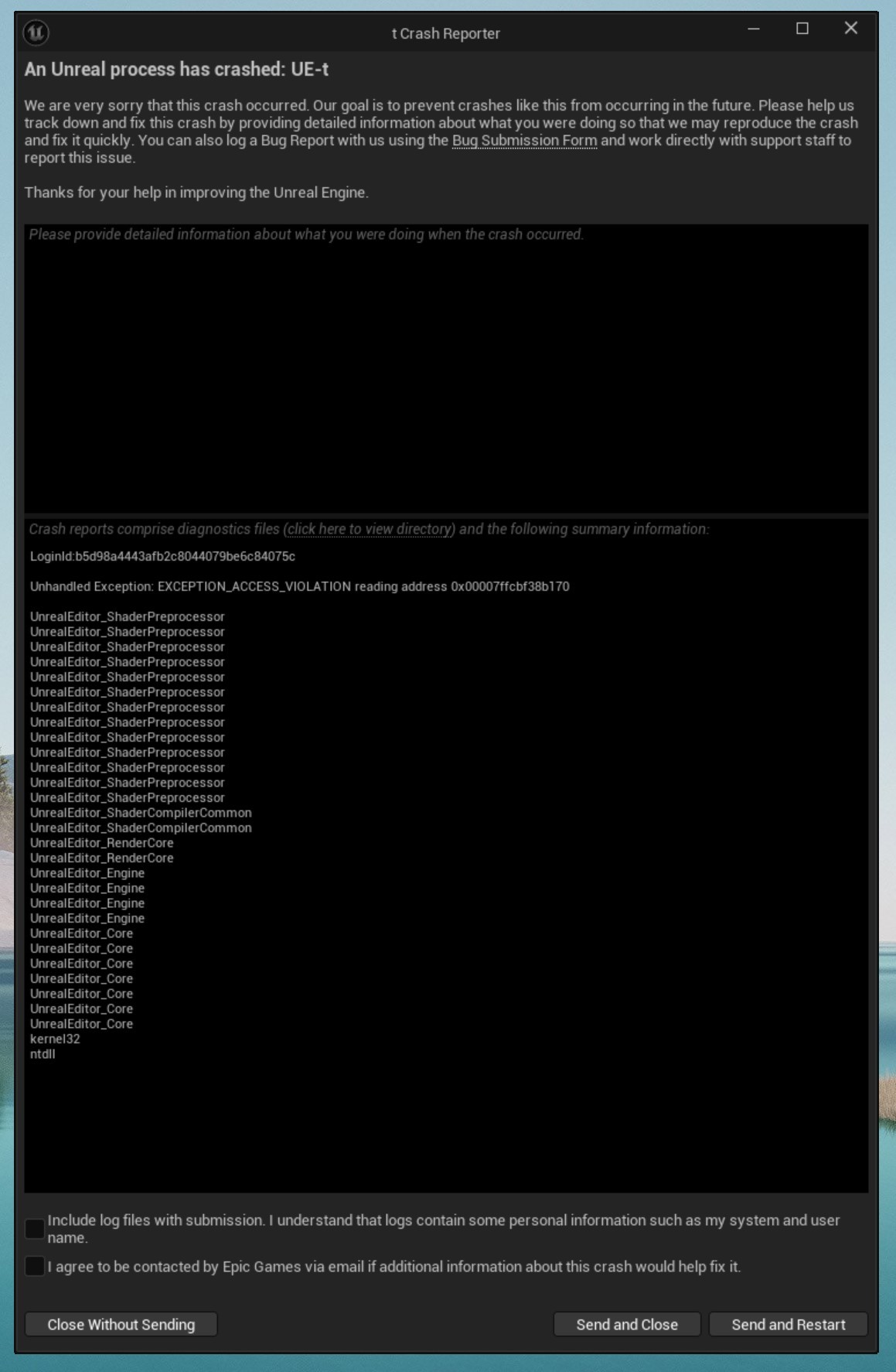

    Thirdly, when I launched Unreal Engine, the system crashed and displayed the following message:
    Lastly, during another attempt to launch Unreal Engine, the computer completely froze during the loading process. I waited for about 10 minutes, but there was no response, so I had to hold down the power button to force a reboot.
