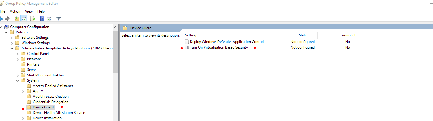

    Hi all
    we had the same issue. It is caused by Win11 Device Security settings, Win 11 23H2 suffers the same fate. These features I believe are now turned on by default with this release when using Enterprise and Education Versions on Win11. If using a GPO you can set this feature to Disabled here. Howver this substantially reduces your security posture so is not recommended.
    The underlying issue is that MS-CHAPv2 is no longer a secure auth method so you will nead to switch to EAP-TLS Certificate Based Auth when using Wireless Authentication. I need to emphasise this was our experience so, use this at your own risk (TEST TEST TEST!!!) and please use this setting with caution as it is a bit of a mission once you Disable this setting to reinstate default Windows Security settings such as Core Isolation, Driver Guard etc... but it is a temporary work around for now.
    We have now permanently overcome this issue by means of configuring our Enterprise CA, to issue Machine and User Certs throughout our Domain using Auto Enrollment GPO Policies and authenticating using EAP-TLS Thankfully the issue is no more....
