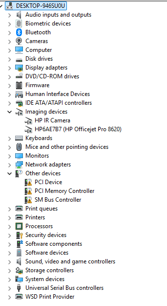

I have an HP All-in-One 27-a275na.
All was working well under Win11 23H2 and just downloaded the ISO for Win11 24H2. Kept only my data to get the benefit of having the best possible install and then reinstalled only the latest versions of the apps I wanted.
Have checked for corrupted files (none found), deleted the Facial Recognition (Windows Hello) Software Device in Device Manager & Rebooted.
On restart the machine fails to start camera and asks for PIN and then when I try to setup Windows Hello Facial Recognition I get the Error Message " Sorry, something went wrong. Couldn't turn on Camera. Make sure it's working properly.
On checking the camera app it all appears to be working properly, and the windows settings allow apps to contact it!

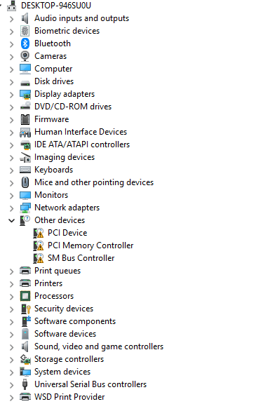

    Thank you for the screenshot, your chipset drivers are not installed correctly.
    Go to the support page for your PC on the HP website, then from there, download and install the version of Chipset drivers they recommend and while there, if you do not have your drive encrypted with Bitlocker, check for any BIOS update that may need to be installed
    2024-10-02T14:18:06+00:00
    The main issue I think with PCI drivers is that this relates to an internal WiFi5 card that I am not using as I have an external WiFi 6 device.
    In their infinite wisdom HP decided not to support Windows 11 on this device, so there are no further driver updates.
    Still not sure why Windows Hello, doesn't work under 24H2 as did under 23H2.
