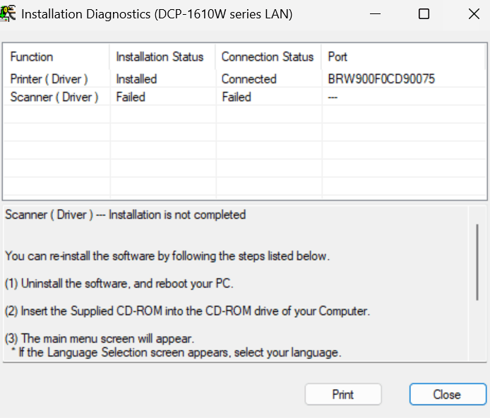

    I have the same issue with W11 compatible DCP -1612W scanner/printer. All worked fine before 24H2 update and now scanner appears as not installed, drivers fail to installed and I cannot use it anymore even after reinstalling the the whole driver package only the printer works.
    After talking to Brother support they told me this issue is caused by MS and I should contact Microsoft as there is nothing they can do...
    Thing is I payed for a device - compatible with W11 - and than W11 update killed one of its functions - MS is this a joke? Please fix asap.
    FYI: 1610W and 1612W share the same driver. Issue occurs on both LAN and WiFi making the scanner useless.
