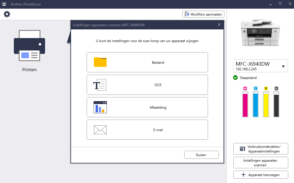

    Hello haramo.
    I no longer use ControlCenter4 but just iPrint&Scan. You can also set all kinds of things there. I can't help you in detail. You'll have to find that out for yourself.
    Apologies for the screenshot in Dutch.
