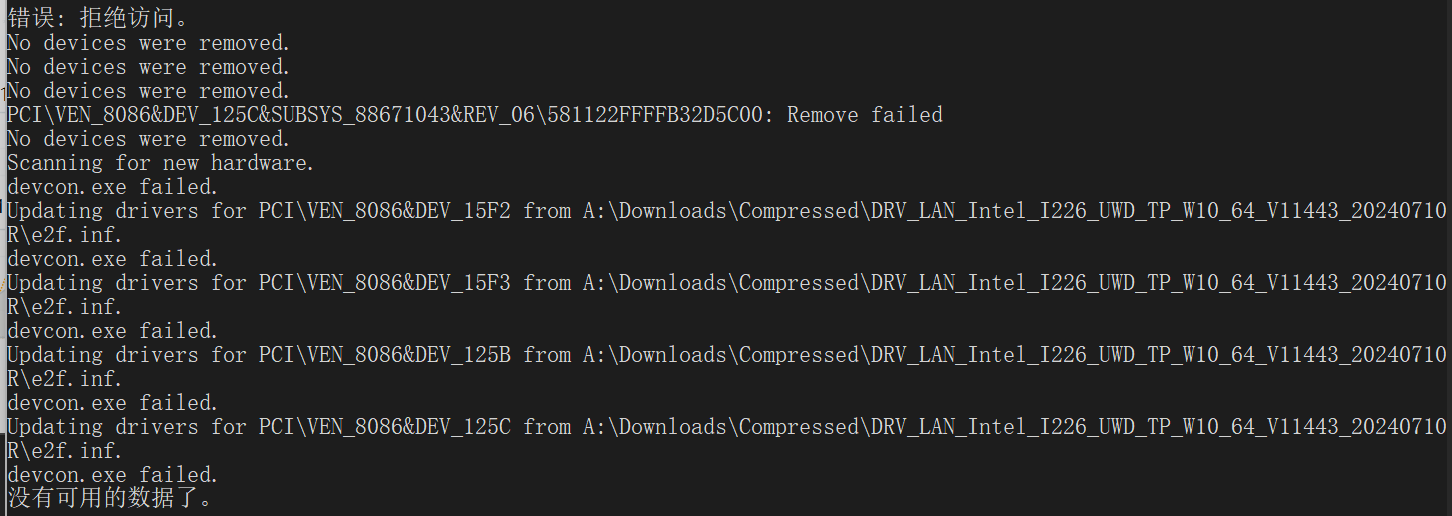

    You need to run that CMD file from WinRE, not Safe mode.
    2025-01-16T03:22:37+00:00
    It says there are no restore points on my PC.
    Also tried running CMD file in safe mode and still can't see the two drives.
