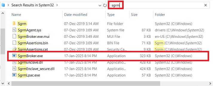

    From my search for "sgrm" in C:\Windows\System32 from File Explorer. It looks like my SgrmBroker.exe was last updated 17-Jan-2025, which is the same day Windows Update installed my KB5049981 monthly cumulative Quality Update (Win 10 v22H2 OS Build 19045.5371) along with my other January 2025 Patch Tuesday updates.
    I suspect your randomly-occurring BSODs have nothing to do with SgrmBroker.exe since my Event ID 7023 errors for the System Guard Runtime Monitor Broker service only occur when I boot up in the morning or restart Windows. I also don't recall anyone else confirming that these Event ID 7023 errors are causing BSODs, but I might be wrong about that.
    In a worst case scenario where an analysis of your full dump files with WinDbg confirms SgrmBroker.exe is responsible for your BSODs then 0xb1a's 20-Jan-2025 post <here> on page 4 of this topic includes instructions for disabling the System Guard Runtime Monitor Broker service. However, Microsoft has warned that "There is no need to manually start this service or configure it in any way (doing so might trigger errors unnecessarily). Future Windows updates will adjust the components used by this service and SgrmBroker.exe".
