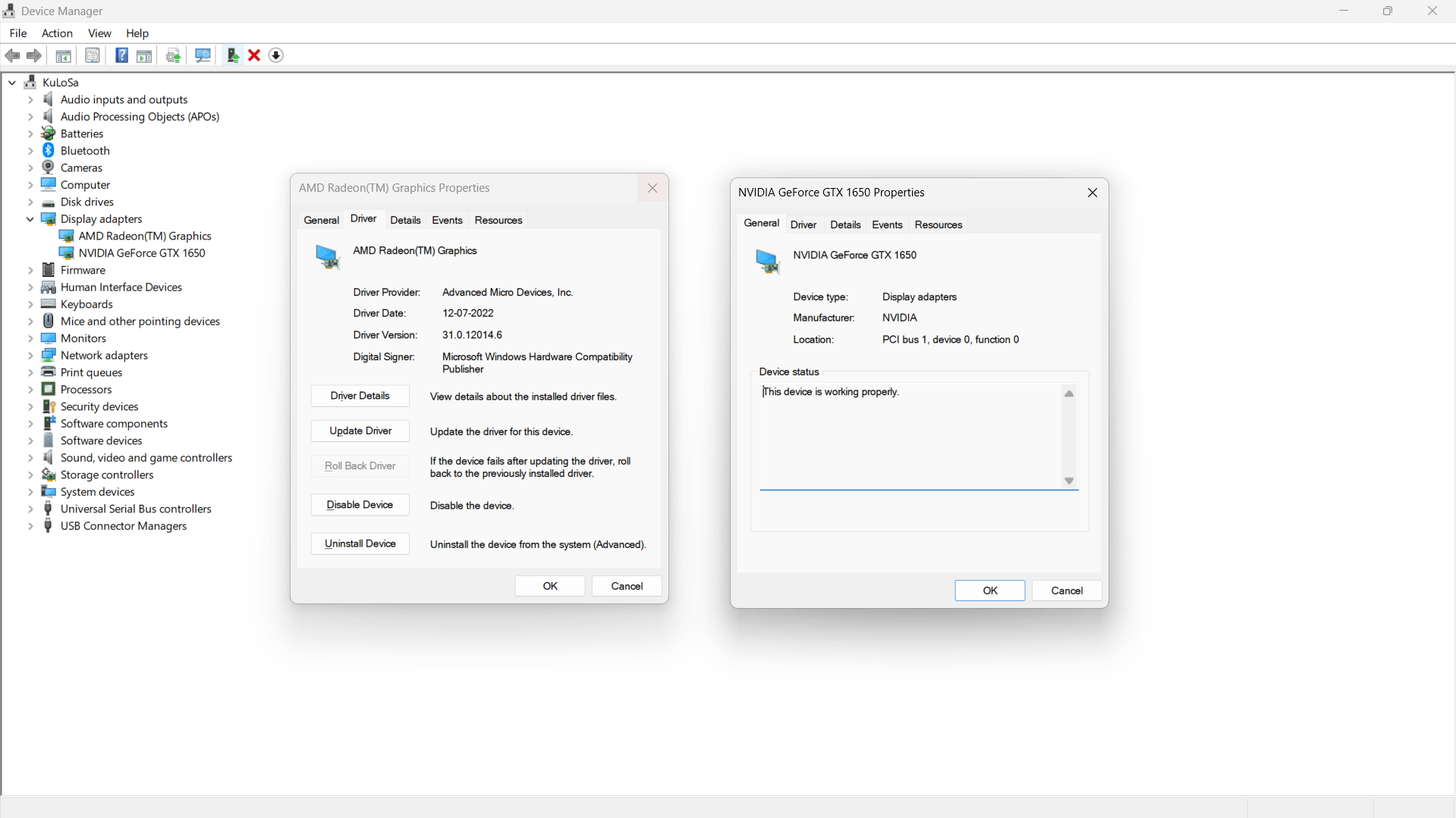

Thank you for the screenshot, you indicate you have previously re-installed the graphics drivers, was that just for the Nvidia drivers?
Open Device Manager, then expand the Display Adapters section, what device(s) do you find in that section?
