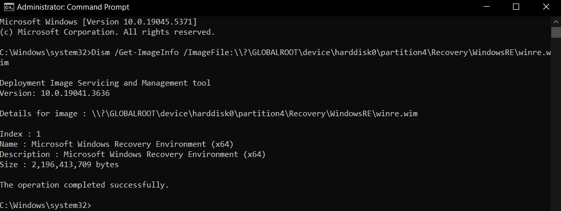

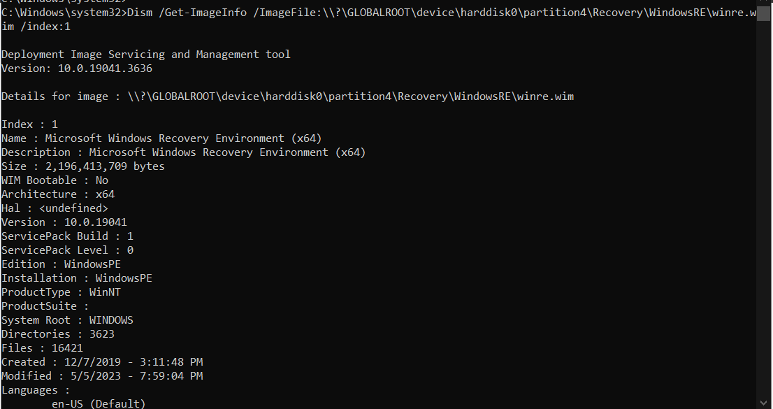

    2. Looks like the Winre.wim image seems never updated. It may be due to the bad block errors you're getting. If the C drive is not BitLocker protected, we can move Winre.wim to see if the update installed correctly.

    Can you upload Fixlog.txt?
    Also, post the output of these two commands:
    • Dism /Get-ImageInfo /ImageFile:\?\GLOBALROOT\device\harddisk0\partition4\Recovery\WindowsRE\winre.wim
    • Dism /Get-ImageInfo /ImageFile:\?\GLOBALROOT\device\harddisk0\partition4\Recovery\WindowsRE\winre.wim /index:1
