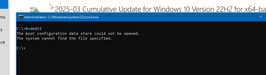

    2025-03-21T14:08:18+00:00
    Booted back into Windows and got to admin CMD, but same error as before:
    Should we try and install the update, or check for anything else?
  4. Ramesh 181.9K Reputation points Volunteer Moderator
    2025-03-21T13:36:59+00:00
    Please restart the system, boot into Windows.
    Run BCDEDIT
    Does it work correctly?

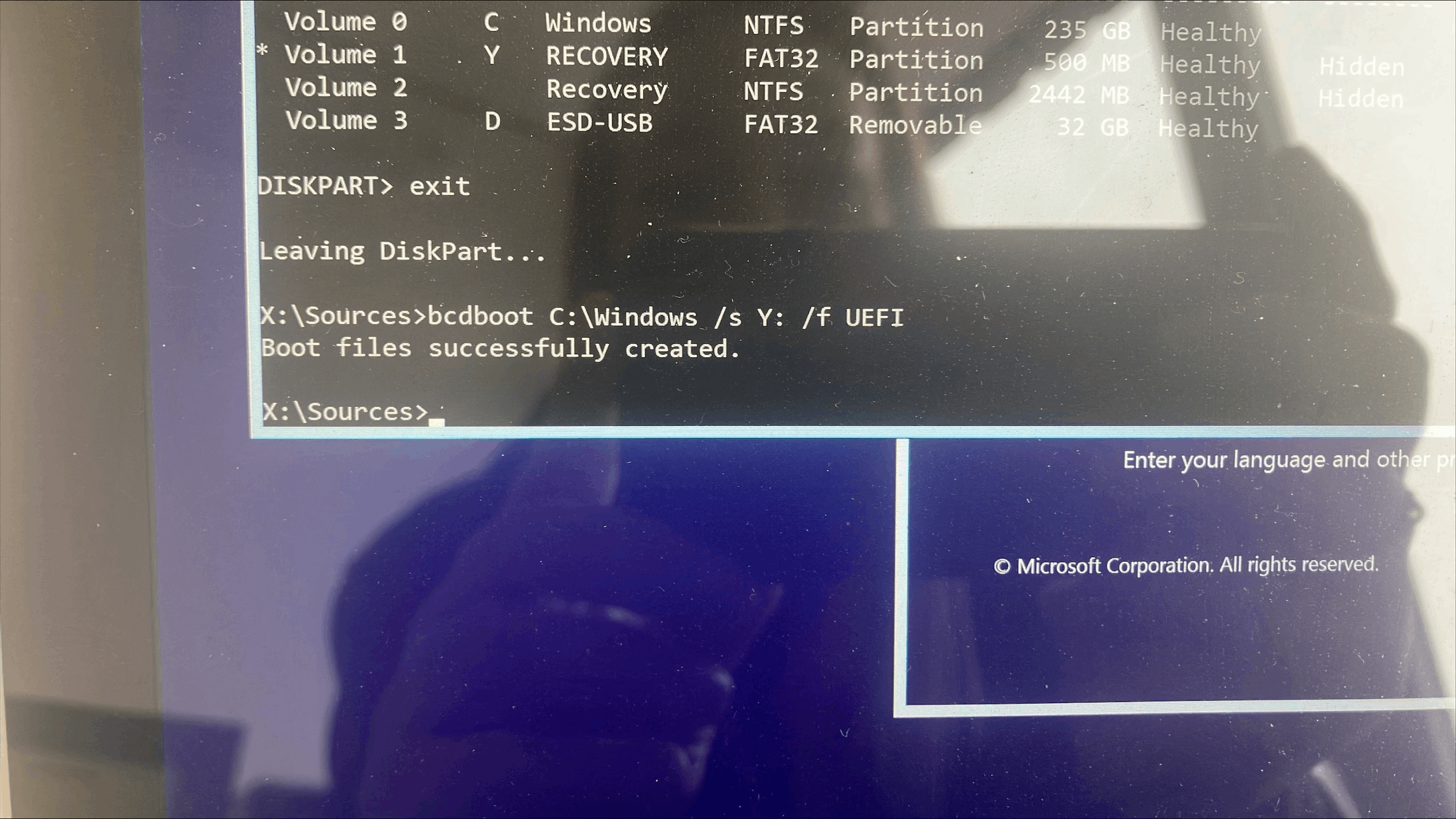

    2025-03-21T13:30:41+00:00
    Cool - so got Bitlocker turned off and it ran succesfully:
