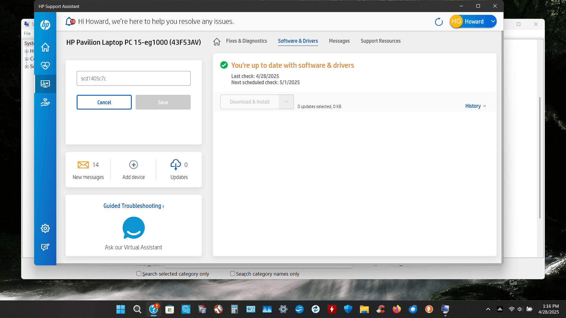

    According to the HP Support website, all my drivers and software are up to date. There is no BIOS update listed for my device. The current Chipset driver is from 2023. So it appears they are up to date. Now what can we do?

    Although the chipset driver might be up to date, it could still be corrupted. To address this, please run the installer I recommended and reinstall the driver to ensure its integrity. HP Support Assistant does not check the integrity of drivers, only their versions.

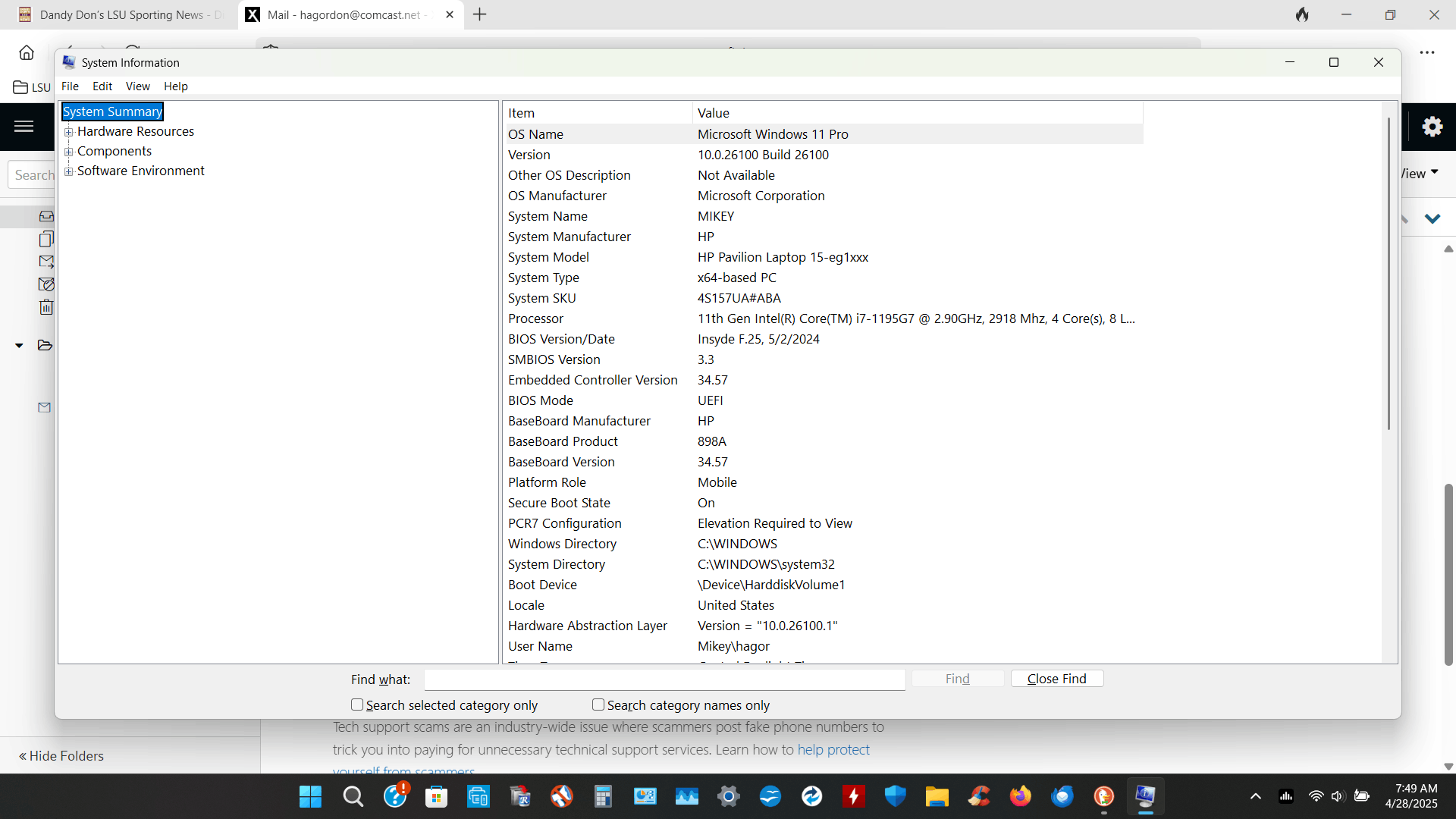

    Regarding the BIOS, the screenshot you shared shows it is currently at version "F.25". However, HP's website lists "F.27" as the latest version, confirming that the BIOS is indeed outdated.
    I strongly recommend proceeding with the BIOS update as suggested earlier.
    HP Support Assistant is not always correct. That's why I suggested doing the procedures manually instead of using it.
