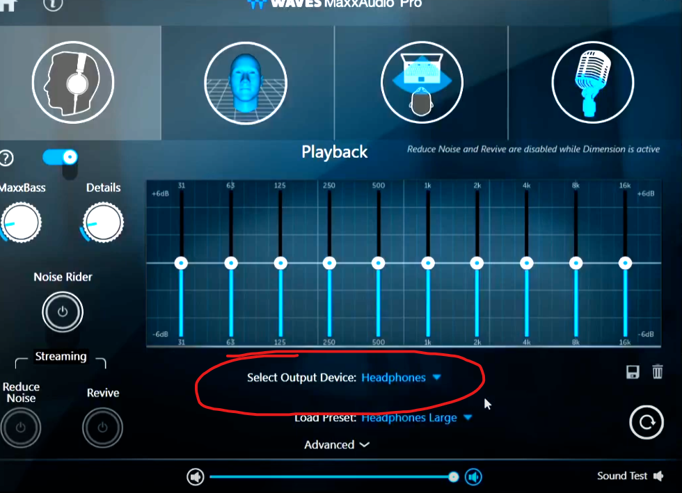

  4. Ivan B 124.1K Reputation points Independent Advisor
    2025-06-02T05:29:28+00:00
    Hi ,
    If yours doesn't work, the Realtek console, what works is Wavemax, it has to open and there will be an option to select output device and you can select the type of input, which should be speakers or headset.
    Independent Advisor - Community
