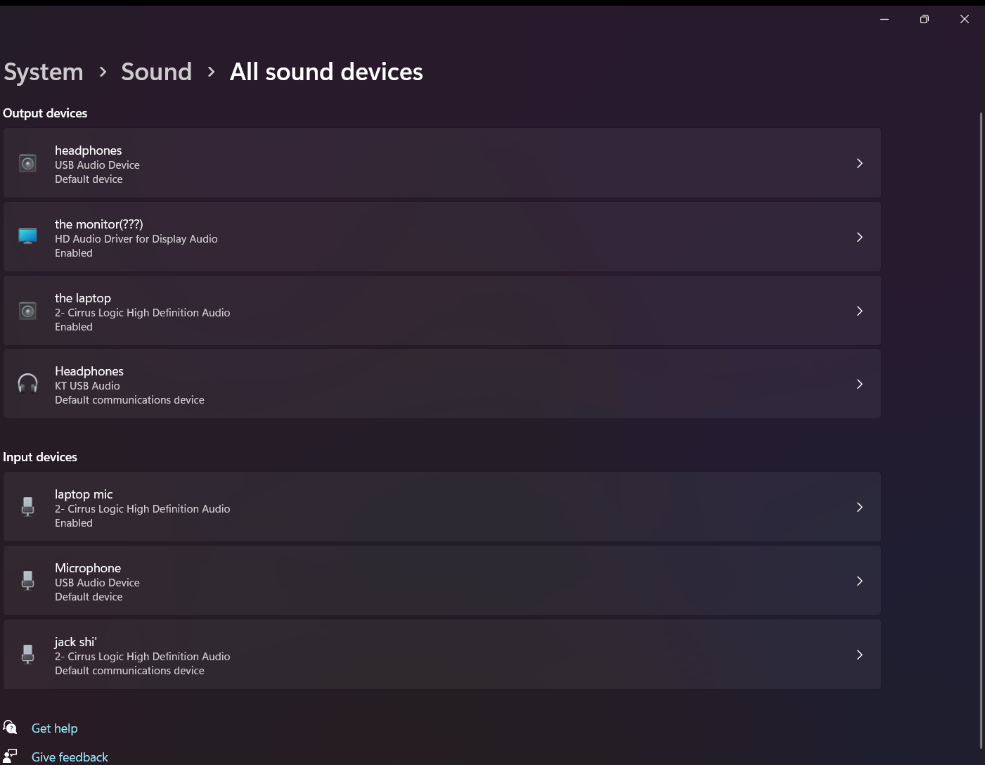

I have a Windows 11 home, Dell laptop Inspiron 15 3520. haven't called from my computer in a good 4-5 months, and when I tried recently my friends told me that the sound was bad, to which I checked which microphone was in use(I have a specialized microphone, a microphone built into the headphones, and the microphone built into the computer), I couldn't find the specialized microphone. I know it previously worked because of the calling and other projects for school where I recorded myself using the microphone.
I checked settings and the microphone(which shouldn't, to my knowledge, have an output feature--and also I tried "testing output" and nothing happened) was in the output section, no where to be seen in the input.

    2025-06-02T20:16:33+00:00
    "KT USB Audio" is the microphone. I have it in the jack to usb-a adapter because the laptop's jack stopped working actually(like just now idk what happened)
    laptop mic is the built in mic
    usb audio microphone is from the headset(that I use for output but don't necessarily want to use the mic on it)
    and the one labeled "jack...", I'm not too sure what it is. I assume it's a bug with the monitor, but can't be the microphone because it stays when I unplug it.
