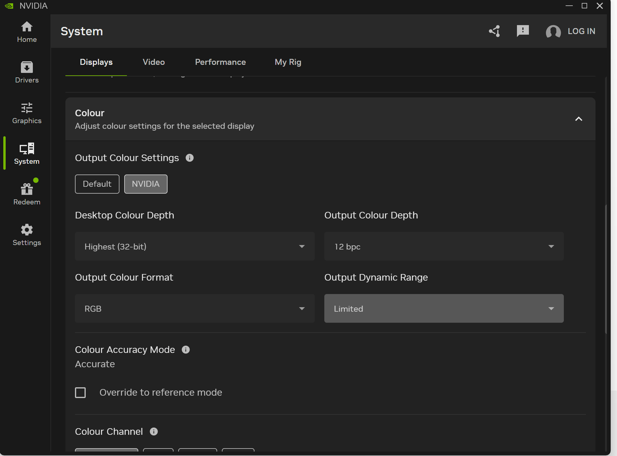

    2025-06-12T12:25:56+00:00
    OK the "fix" for me appears to be to set the output dynamic range to "limited" in nvidia system settings/displays/colour
    Yep, this one works for me so far. Changing it from Full to Limited. Nice catch.
    It will do for now until we get an update to fix this forced Dolby Vision issue.

    2025-06-04T17:01:53+00:00
    Same here.
    LG C2 OLED + RTX 4080
    Screen turns green and pink. Have to enable and disable DV to back to normal.
    Other option that I found is reduce the color range in NVIDIA Control panel from 'FULL' to 'LIMITED'.
    Nvidia Control Panel -> Resolution -> 3. configurations ... -> Use NVIDIA Color Configuration -> Dynamic output: LIMITED.
    It makes the video output not DV compliant, disabling it...
    RGB - 10bpp - Limited
