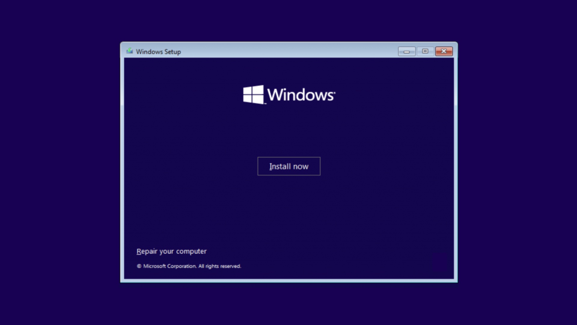

  1. Manoel Barros 22,030 Reputation points Independent Advisor
    2025-04-27T00:11:19+00:00
    No, now that you have selected the Flash Drive, you must click Exit and wait.
    You will be redirected to an Installation Menu (Image Attached).\

  4. Manoel Barros 22,030 Reputation points Independent Advisor
    2025-04-27T00:02:45+00:00
    Is your USB Flash Drive from Kingston?
    I think the UEFI Kingston DataTraveler should be your USB Flash Drive, and the UEFI RST BM9C1 Samsung 1024GB (1TB) should be your SSD.\
    Uncheck all options and leave only UEFI Kingston DataTraveler checked > Save and Exit > See if you can access the Installation Menu.
