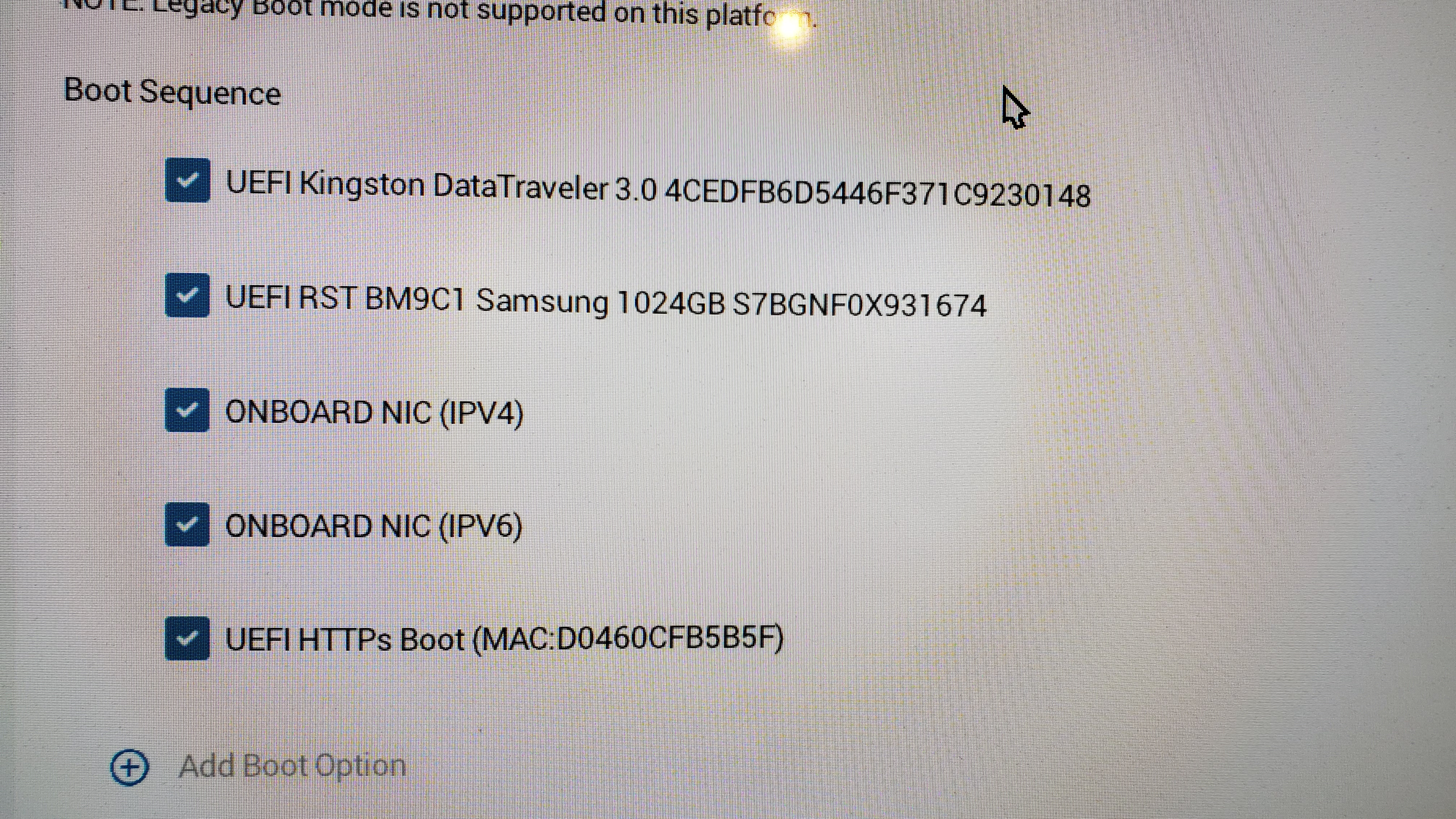

    2025-04-26T23:53:53+00:00
    I got into the Boot Sequence. Here's a screen shot of the options. There are 3 UEFI options. This is the Bios Setup screen (this is where it took me when I kept doing a forced shutdown on the blue screen). The Kingston is the USB drive.Image
  2. Manoel Barros 22,030 Reputation points Independent Advisor
    2025-04-26T23:42:45+00:00
    You can try this:
    1. During the Blue Screens, do a forced shutdown by holding the Power Button of the laptop. Do this until you can access the Recovery Environment (a blue screen with the options "Advanced Options"/"Troubleshooting" and "Shutdown/Restart".
    2. Select "Advanced Options"/"Troubleshooting" > "Use a Device" > "Select Installation Media" (Usually starts with UEFI and the name of the manufacturer of the USB Flash Drive).
    • Alternatively, choose the option Firmware Settings
