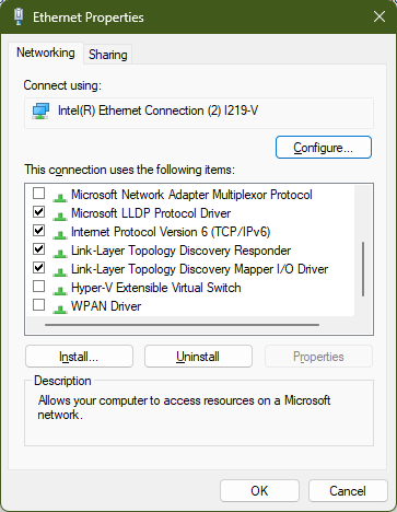

  3. Ramesh Srinivasan 88,100 Reputation points Independent Advisor
    2025-06-08T16:13:59+00:00
    1. Please scroll down and post a screenshot of the remaining entries.
    2. Last time, SFC was run before running DISM. The recommended way is to run DISM and then SFC.
    So, rerun SFC and post the latest logs.

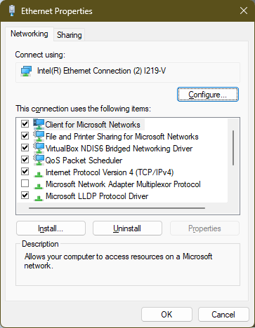

    2025-06-08T16:12:05+00:00
    Hi Ramesh,
    Here's the Ethernet Adapter properties. There are also Ethernet 2 and Ethernet 3, which are Virtualbox Host-Only adapters. Did you need anything else from this?
    I tried rerunning SFC and got the same result; it fails at 6%.
    Given that the CBS logs were posted after I ran SFC and DISM last time, I assume they haven't changed, though I'll update this post with the latest version shortly.
