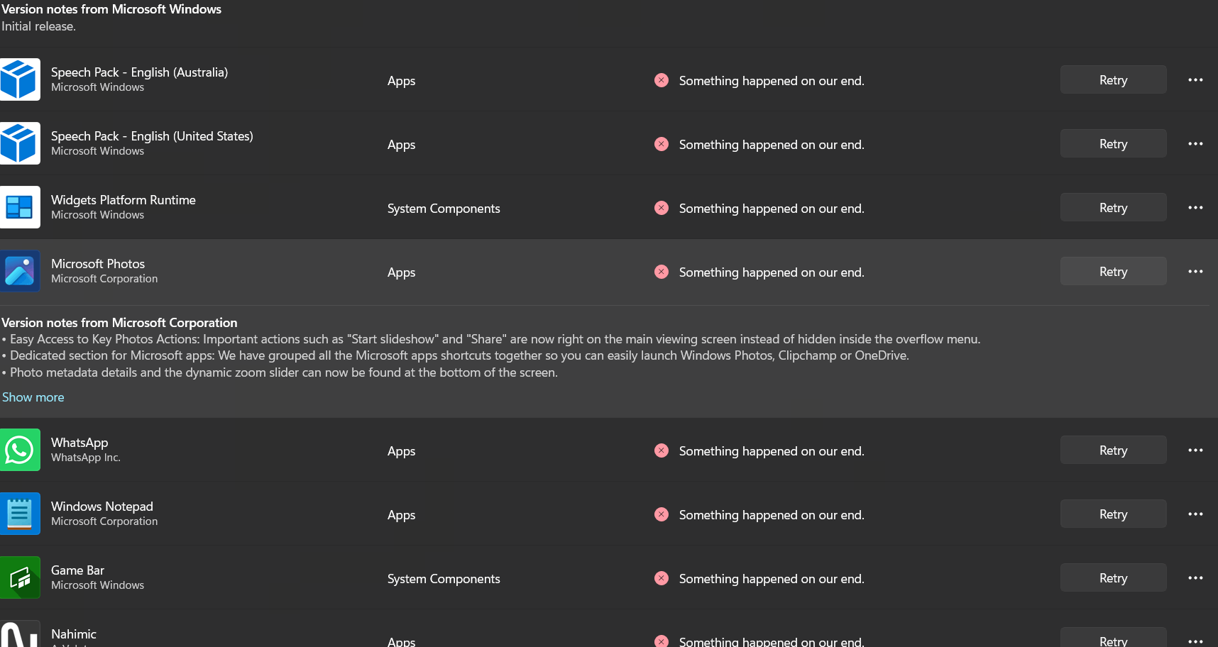

i am getting this problem because recently i downloaded some windows update then my taskbar stopped working it's not showing also, then i deleted the update after that i am getting this problem.

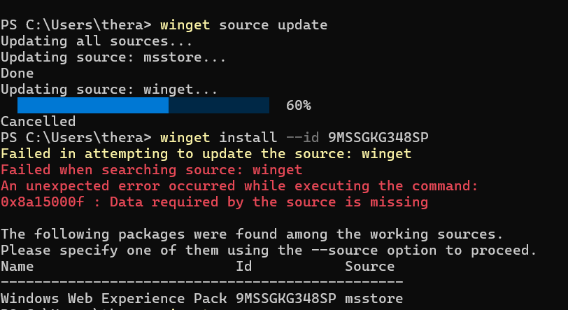

    i can see the winget version but no other operation i can do with it and also winget is not in C:\Users\YourUsername\AppData\Local\Microsoft\WinGet
