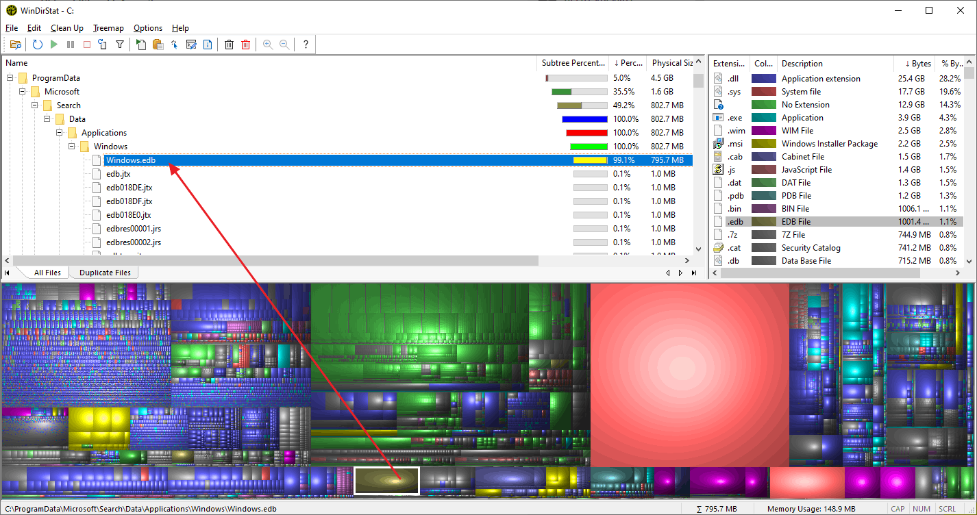

    Hi sms1295,
    Ok. But as you have many disks connected to the system, you should be able to move some data files to those drives temporarily and rerun the 24H2 setup. Clearing the C:\Windows\Softwaredistribution folder and your browser caches for each profile can free up gigabytes of space. Additionally, TreeSize or WinDirStat can further free up space on the C drive.
    WinDirStat - Windows Directory Statistics:
    https://windirstat.net/
    Download the tool and run it as administrator. Wait until it populates the entries and constructs the treemap.
    The treemap represents each file as a colored rectangle, the area of which is proportional to the file's size. When you select the colored rectangle, the corresponding file is highlighted automatically.
    For example, I select a rectangle in the treemap. It highlights the corresponding file in the folder view.
    Identify the large files and eliminate them.
    Sample screenshot.
