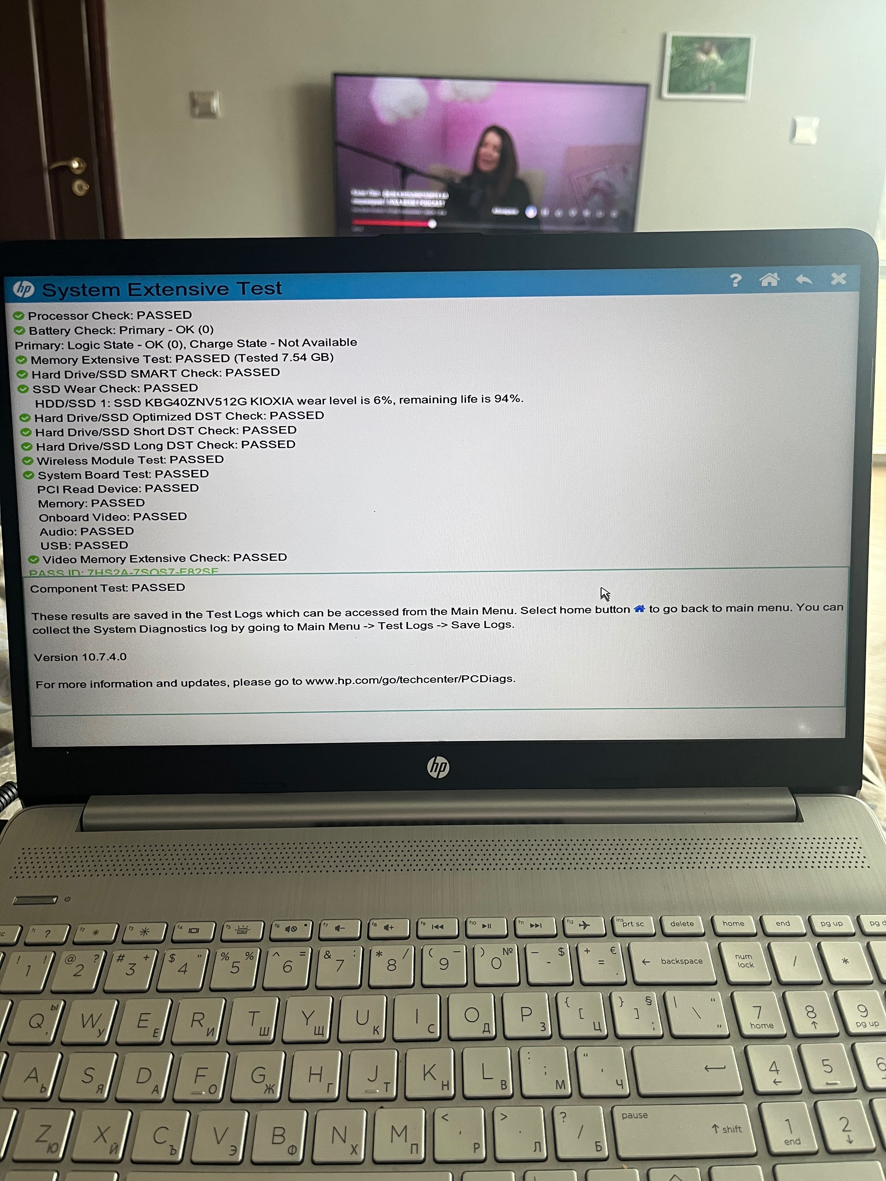

    2025-04-12T08:28:43+00:00
    The test finished 2 loops and Everything is perfect. Here are the results:
    2025-04-12T07:56:04+00:00
    After HP UEFI hardware diagnostic testing:
    1. Post images or share links
    2. Post share links for steps 1 - 5 in my earliest post.
    Make sure that these are new runs (after the most recent upgrade failure)
    1. Start WDV testing (only if HP UEFI reports pass after testing Drive, RAM, CPU, GPU, motherboard, etc)
    The WDV testing will be interactive > new customized tests will be posted after viewing verifier /querysetting or V2 results.
