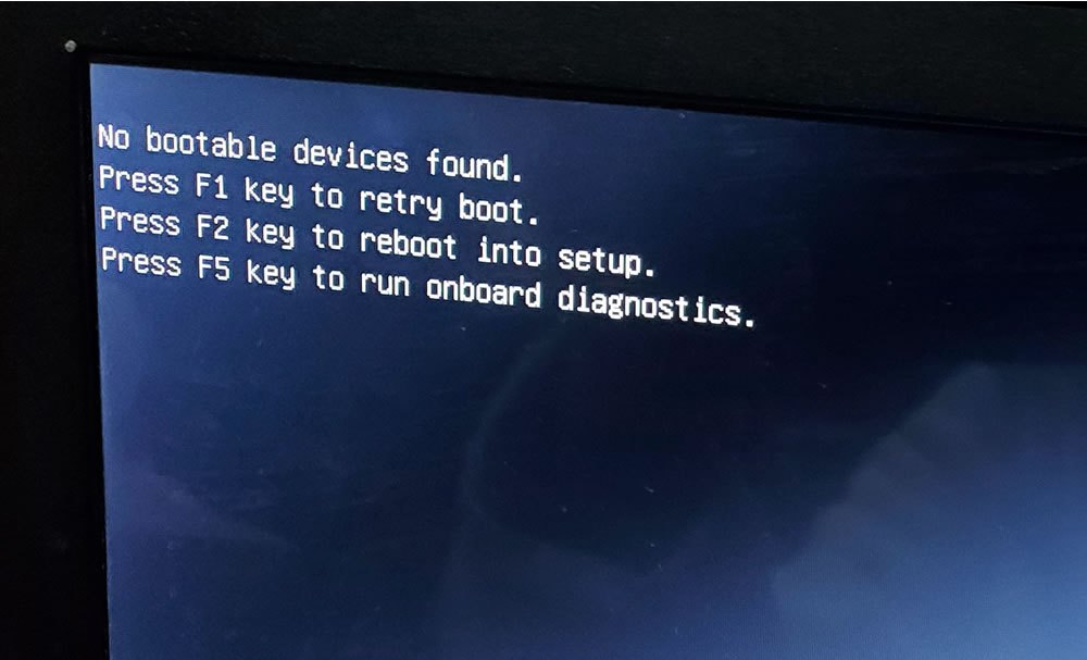

    BEFORE TRY TO reinstall, or DUAL BOOT Windows 10
    I am trying to fix the laptop
    But as you see from screenshots
    HDD needed fix or does Windows 10 need fixing...? What of the two try FIRST...?
    Run:
    bootrec /FixMbr
    bootrec /FixBoot
    bootrec /ScanOs
    bootrec /RebuildBcd
    <reboot>
    Or run:
    first with CHKDSK, then SFC, and finally DISM
    Or...?
    If reinstall or DUAL boot may Not succeed due to errors on the HDD...? So, may I need to fix these first?

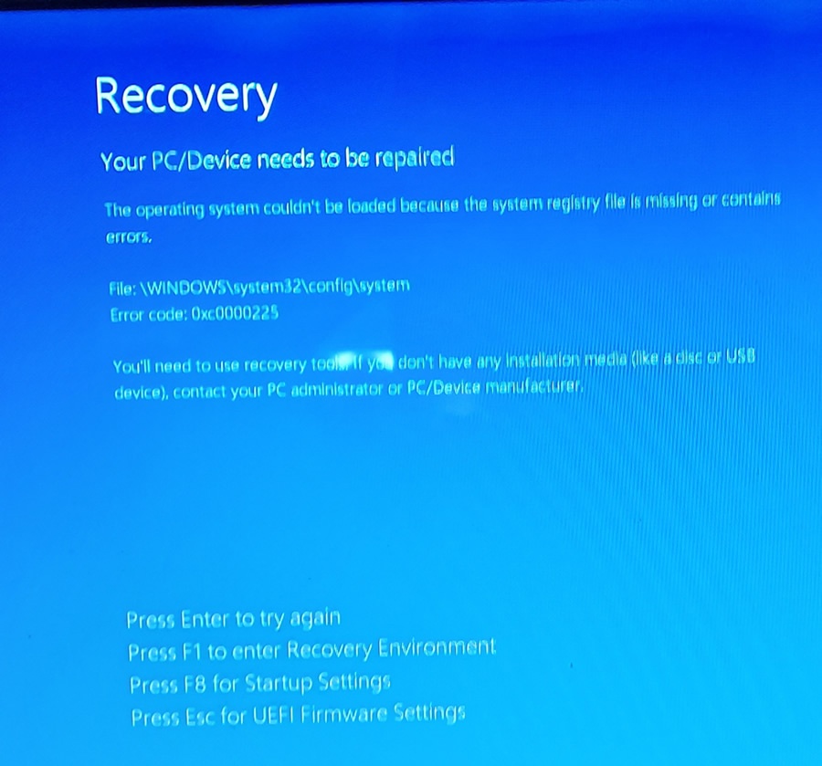

    last boot attempt ERROR:
    ![](https://learn-attachment.microsoft.com/api/attachments/3dd396a7-d44d-4bb7-a843-ca5c22845d1c?platform=QnA

    sometimes
    ... os could not be loaded because the system registry file is missing or contains errors.
    error code
    0x0000017

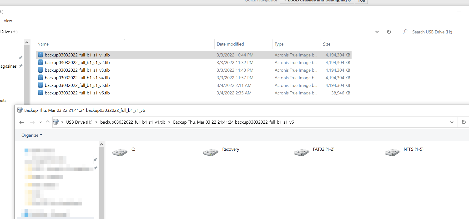

    Install Windows 10 dual boot, [ how to understand current Windows 10 is Home or Pro --- if can Not boot??? ]
    The backup shows in loading the media USB stick in another PC, Windows 10 ...
    which is the main partition and three others below 1GB...
