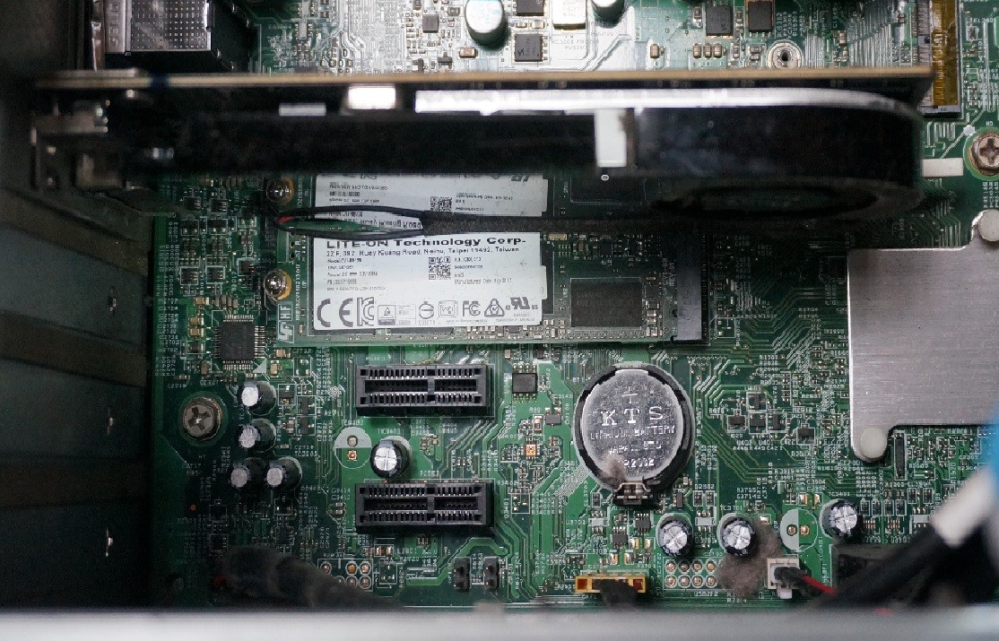

    2021-09-27T10:19:53+00:00
    Thank you.
    This is what I did 2 hours ago.
    1.Took the CMOS battery out of its socket for about 9 minutes, and put it back, & started the PC to see if any difference. No, it did not make any difference.
    2.Took the SSD off the main board & disconnected the hard drive SATA3 & started the PC.
    This, neither made any difference. The start up process stuck at the acer logo & keyboard, mouse, and all the USB ports were dead as before.
    What is the next to try?
    Thank you.
    Chuenmon
    2021-09-27T09:13:40+00:00
    That is not the same as taking the CMOS coin battery out. I wish I could find your owner's manual, but I can't. It would have instructions how to remove the battery &/or the SSD. Gently see whether you can move the clip back in that photo or whether you must flip the battery out with a fingernail at the opposite end of the clip. As far as removing the SSD, I think Slance can better describe it. I can't find a video showing it for your T3-715. Look through some of these until you feel comfortable you can do it...
    https://www.bing.com/search?q=How+to+remove+the+ssd+of+an+Acer+Aspire+T3-715&form=WNSGPH&qs=SW&cvid=d06c0d9fc908463abbaf78b92fc1d4fb&pq=How+to+remove+the+ssd+of+an+Acer+Aspire+T3-715&cc=US&setlang=en-US&nclid=4EC4ED8862E44BE6FC487D6A23719A82&ts=1632731302747&wsso=Moderate
    BING of "How to remove the SSD of an Acer Aspire T3-715"
    The T3-715 isn't there, but the process must be similar.

    A gentleman told me years ago that by disconnecting the power & then holding the start button down for 2~3 minutes would reset the BIOS. I did. Saw no difference. Some others say that coin battery MUST be taken OFF the main board for the battery to reset the BIOS. I have not yet tried this. I'll right after posting this talk.
    "resetting the Bios . . . a button on the back or on the motherboard to do this."
    Just a few seconds ago, I took a good look at both the back of the machine & the main board, but did not see any button. Or, I saw it but did not recognize it.
    The CMOS RAM battery is located next to the SSD. See photo
    It looks that there is a spring catch at the lower edge of the battery & it looks pretty tight. I do not know how to get the battery out without a proper tool.
