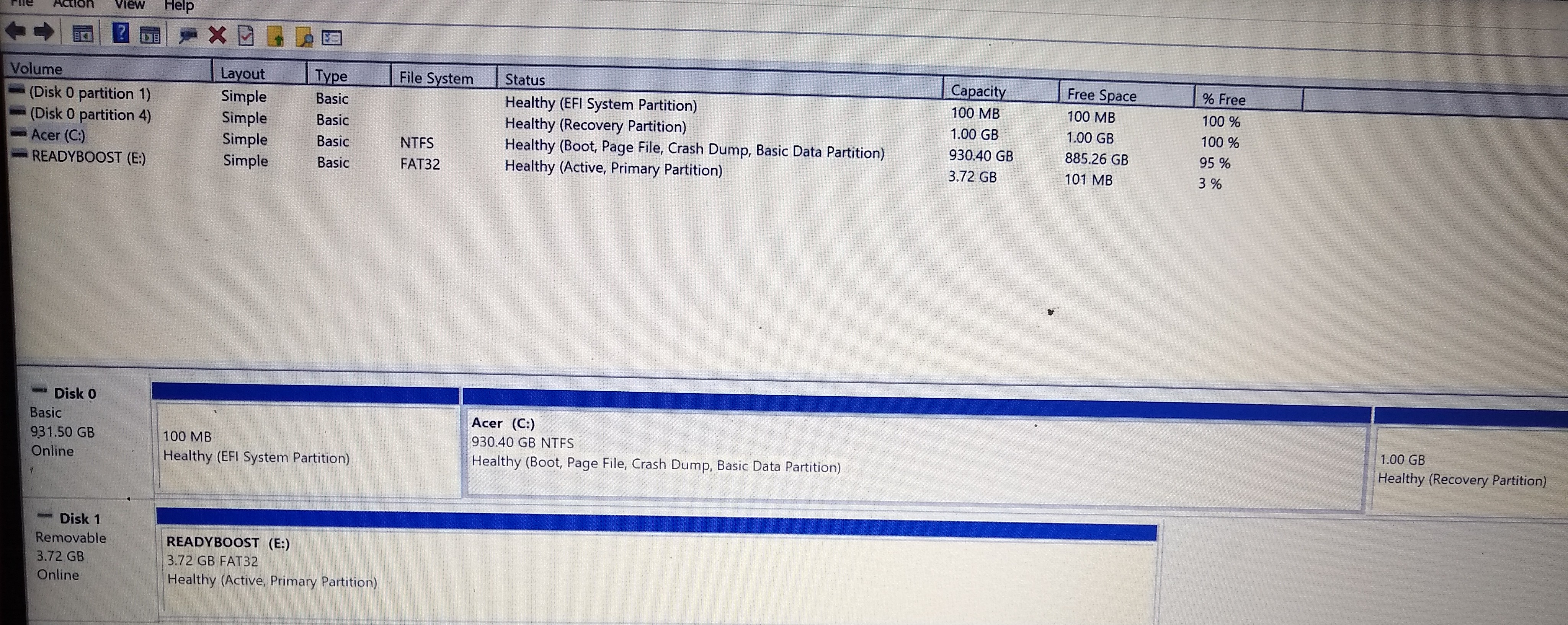

    I hope the pic I posted is alright. I don't have the computer connected to the internet right now in case it's malware causing the problem so getting a screenshot was difficult.

    Please post a screenshot of Disk Management, which I read like a doctor reads X-rays. Follow the steps here so I can see everything needed to advise you: http://answers.microsoft.com/en-us/windows/foru...
