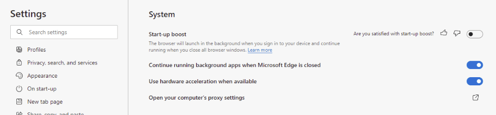

    Was this done in the Edge settings page?

    2021-02-25T10:21:37+00:00
    I've just been looking through the last set of crash dumps you provided.
    It does look like it is narrowing down to browser and graphics. Is there some kind of graphics hardware acceleration that kicks in with the browsers?
    Most browsers have a setting for hardware acceleration which can be enabled or disabled.
