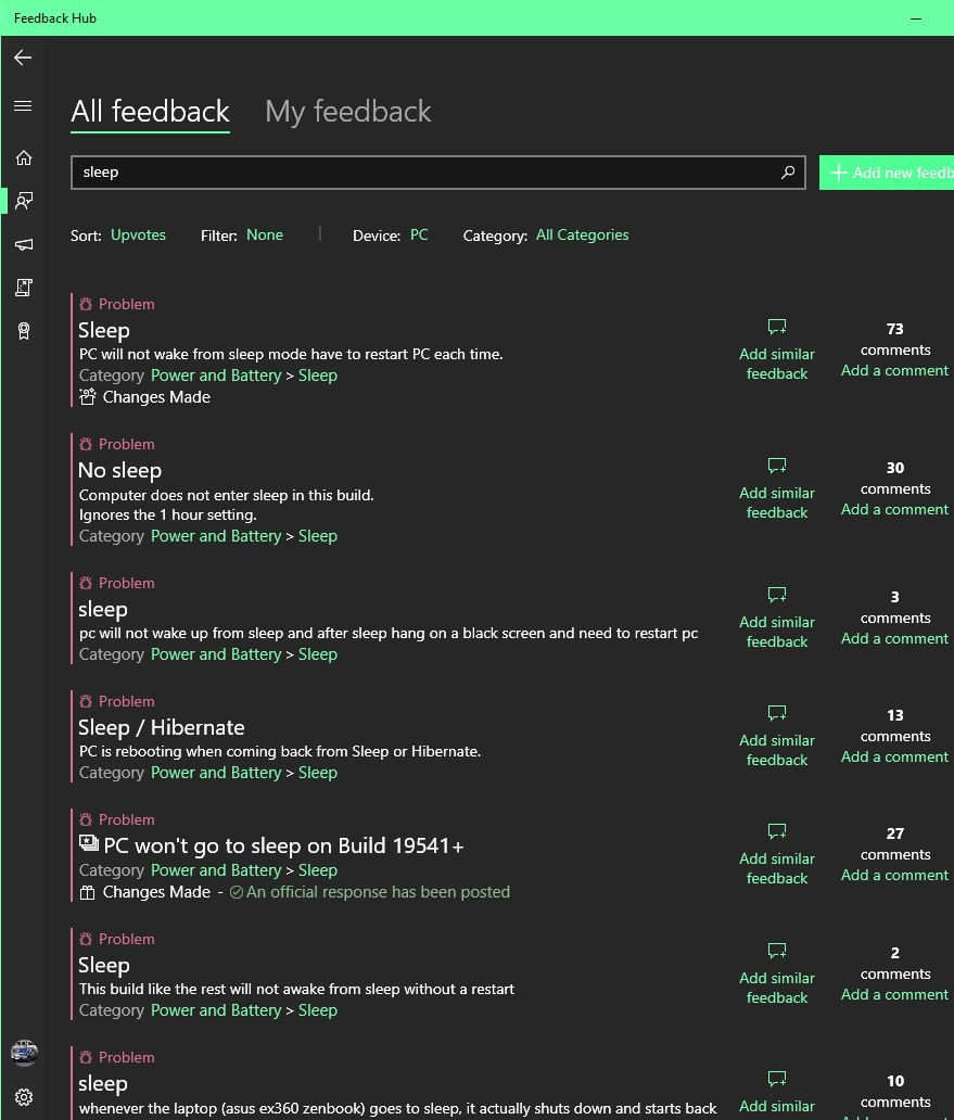

    2020-10-31T11:55:24+00:00
    Can't say I'm having the *exact* issue you are, but there's definitely a lot of sleep-related bugs filed, some with MS acknowledgement of issue/fix.
    I'm definitely seeing 2 distinct sleep issues on v2004 that weren't an issue on v1909:
    1. Laptop often crashes/reboots on wake
    2. laptop crashes instead of going to sleep (eg after the 15min inactivity).
    If you have Feedback Hub app, you can add your own comments or upvote similar issuesto yours. Hopefully they'll consider fixing this basic functionality...
