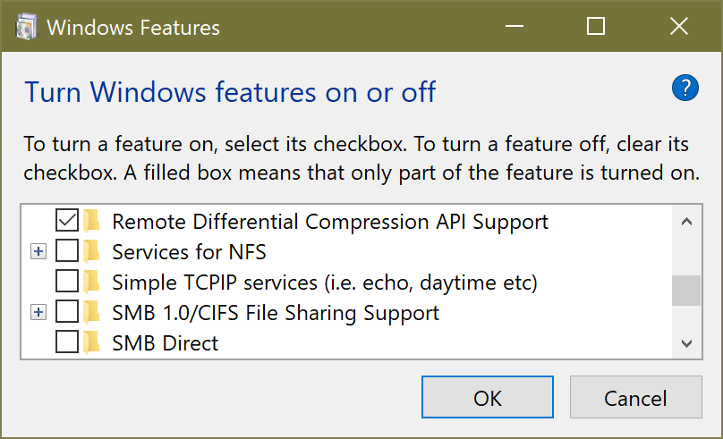

Turn off Windows Features 'SMB 1.0/CIFS File Sharing Support'. SMB DIrect' and 'NFS Client' (unchecked).
- Win + S >Turn Windows features on or off

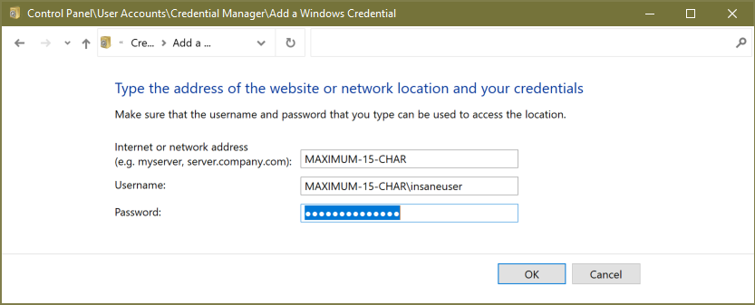

A. Windows Credential with NAS hostname
Use Windows Credential with NAS hostname instead of a domain.
- Win + S >Windows Credentials
- Add a Windows credential
- Set NAS host in front of username
maximum-15-char\insaneuser

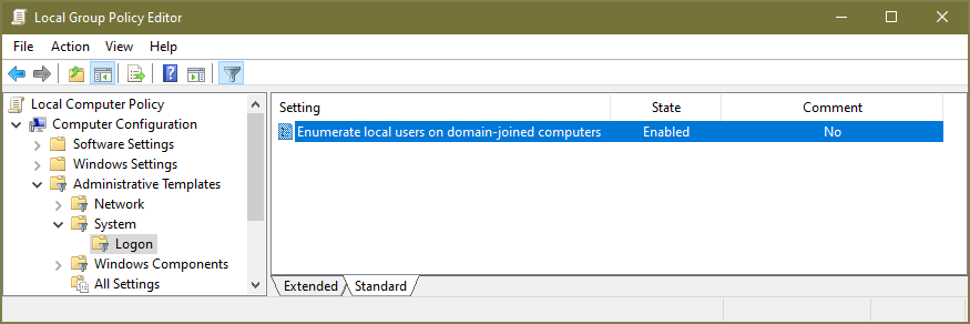

Enable Local Account Login on a Client joined Azure AD
In order to create a local test user account, this must be first enabled.
This is not needed for final solution:
- Win + S > Edit group policy
- enable Enumerate local users on domain-joined computers
HKLM\Software\Policies\Microsoft\Windows\System!EnumerateLocalUsers
3. after testing disable this setting. If you want to keep local accounts, read security considerations of Local
