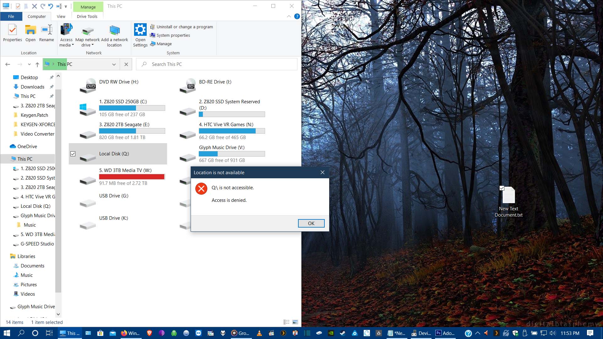

    1. When 2004 was still installed, System Restore failed 3 times. And each time it told me that it failed it told me I should undo the failure. I clicked OK and even that failed. But It didn't seem to anything as well. So I suppose the failure failed? I reluctantly tried reset this PC thereafter with yet another failure to go back. Since I couldn't revert to the previous version of Windows either, I downloaded an ISO of 1909. In recovery ever since.
    I should note that I installed sledgehammer to stop all the updates and give me full control when I want to search and update when I choose. Like the good days of Windows 7.
    1. The drives show up in Disk Management & File Explorer and the drive letters are still the same from before this issue. I even tried changing the drive letter on the drive I already reformatted, with no success as well. The Letter changes, but still no access.
    2. These drives are connected via USB 3.0 from different enclosures, and thunderbolt for the G Speed. Thankfully they all show up under version 1909, just not accessible
    3. No option to Roll Back Driver. After uninstalling "Best driver already installed" from automatic search. Manual search yielded same result. Let me pick installed the driver it displayed successfully, however, still not accessible.
    4. Roll back drivers unavailable on all USB Enhanced, Hub and Host controllers. Following all uninstallations and reboot, still not accessible.
    7.Ran disk checks yesterday and earlier today and a few basic errors were fixed in free space, but aside from that nothing major. Still inaccessible.
    8.These drives show up on my Windows 7 Laptop, the same way they're showing up on Win10 but inaccessible. Cannot open them or see anything files.
    As you can see I attached an image of what im dealing with these drives. Just going to work on one at a time at this point. I'm sure once a solution is found, it should work for all of them! I hope!
